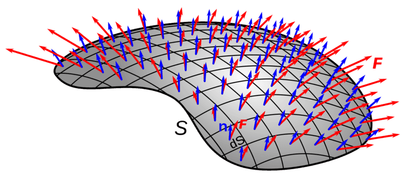

So under the assumption that my photons are emitted isotropically from a point source, the flux of the photons over a surface will be the number of photons per second divided by the area of the surface they hit, regardless of the shape of the surface? ( Because from what I understand, the calculation of flux under the assumptions I wrote just depends on the area of the surface, not on its shape )
What matters is the area perpendicular to the the direction of flow. For a point source and a sphere that will always be true. For a general surface it will involve a vector "dot" product with the local surface normal. This is the usual notation for a projected surface area.
