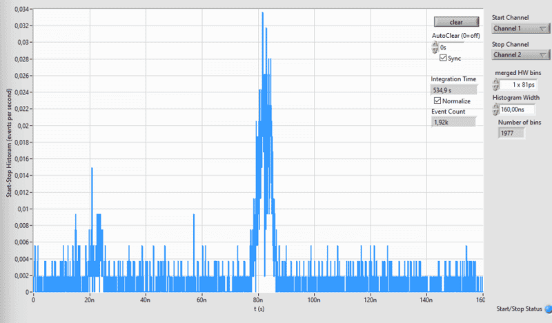

Before doing a complete g(2) measurement I wanted to check if my dark counts are incoherent (which should be the case). Unfortunately, I found that they are not incoherent, I did a measurement measuring the time difference between a measurement at APD 1 and APD 2 and I got peaks at around 20 ns and 80 ns.
You can see a screenshot of the graph below:
I couldn't explain it and no one in my lab has a good explanation for this phenomenon.
The peak at 20ns only happens when the beam splitter is actually coupled to the APDs, so a dark count measurement with the APDs not coupled to anything is completely incoherent (which is what we want).
The 80ns peak only happens when the multimode fiber(not present in the picture) is connected to the input fiber.
I do have a hypothesis though about this but I can't find any source online that verifies this.
I think that during the dead time of the APDs, incoming photons are being reflected, causing them to bounce back through the fiber. They are then reflected again at fiber couplings, the first one being the coupling between the input fiber and the MM fiber and there is another coupling from the MM fiber to another MM fiber.
Some people have advised me to use single-mode fibers instead and APC-APC couplings but if I use single-mode fiber my collection efficiency is not high enough and I don't get enough counts to make any measurement so that is not really an option. Later I want to measure light from single photon emitters in 4H-SiC so the collection efficiency is quite important.
I see there have been no responses yet so here's one: The time between the first small peak and the main peak is about 60ns. That represents a large path delay (20m??) and your image suggests you should expect less than 1m path lengths for any reflections. Could it be an instrumentation problem?
