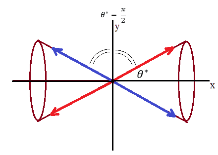

4) The opening angle is ##\alpha = \theta_1+\theta_2##, find the condition required for ##\alpha## to be minimized and calculate it in this condition.
Here I get stuck. I know that $$tan\theta_1=\frac{sin\theta^*}{\gamma(\beta + cos\theta^*)}\quad tan\theta_2=\frac{sin\theta^*}{\gamma(\beta - cos\theta^*)} $$ and I found out on some books that the wanted condition is ##\theta^*=\pi/2## in that case $$\alpha=2arctan \left( \frac{1}{\gamma\beta} \right) $$
but how can I prove that ##\theta^*=\pi/2## is the wanted condition? Are the other results right?

I couldn't think of a short way to show that the minimum of ##\alpha## occurs for ##\theta^* = \pi/2##. I did get it with some tedious :oldfrown: manipulations .
Starting with ##\tan\theta_1= \large \frac{\sin\theta^*}{\gamma(\beta + \cos\theta^*)}##, you can take the derivative of both sides with respect to ##\theta^*## and then manipulate to solve for ##\large \frac{d \theta_1}{d \theta^*}##. With the help of the relation ##\gamma = \large \frac 1 {\sqrt{1-\beta^2}}##, I found that it could be simplified finally to $$\frac{d \theta_1}{d \theta^*} = \frac 1 {\gamma (\beta \cos \theta^*+ 1)}$$ Of course, this should be checked. I get a similar expression for ##\large \frac{d \theta_2}{d \theta^*}##. These results can be used to derive the condition on ##\theta^*## corresponding to ##\large \frac{d \alpha}{d \theta^*} = 0## and to show that ##\alpha## takes on its minimum value here.
Aside: Without any calculation you can argue that ##\alpha## must have a local extremum at ##\theta^* = \pi/2##. By symmetry of the physics, the function ##\alpha(\theta^*)## must be an even function about ##\theta^* = \pi/2##.

thanks! I got confused using the tangent because of the asyntotes at ##\pi/2## so I would prefer a proof without it. Anyhow I cant find a clear way to state the result using symmetry, for sure we can see that ##\alpha## has maxima at ##\theta^*= 0,\pi## but I don't know how to formulate the symmetry around ##\theta^*=\pi/2##...

In the CM frame, consider a pair of photons, shown in red below, for which one of the photons is emitted at the angle ##\theta^*## to the x-axis.
As long as one of the photons is emitted in any direction that lies on the cone, then we will get the same value for ##\alpha## back in the lab frame. Consider the blue pair of photons on the cone as shown below.
The blue pair will have the same value for ##\alpha## in the lab frame as the red pair. But the red pair and the blue pair make the same angle relative to the plane corresponding to ##\theta^* = \frac{\pi}{2}##. This plane is the y-z plane. The z-axis comes out of the page and is not shown in the figure.
Start with the red pair initially at the angle ##\theta^*## in the CM as shown and then continuously increase ##\theta^*## until the red pair is coincident with the blue pair. The starting and ending values of ##\alpha## back in the lab frame must be equal. So, ##\alpha## as a function of ##\theta^*## must be symmetric about ##\theta^* = \frac {\pi}{2}##. That is, it must be an even function about ##\theta^* = \frac {\pi}{2}##.
Likes lambdadandbda
Beautiful! Having it written like this it's easy to see that ##\alpha## is a periodic function of period ##\pi## with maximum at 0 and ##\pi## and symmetric about 0, ##\pi/2## and ##\pi/2## and hence with minimum at ##\pi/2##.
