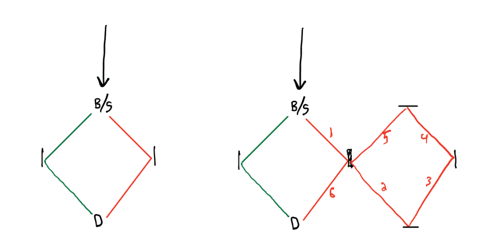

Thanks for answering my questions so far. In particular it was very helpful to understand that the consistency of the source phase is very important when there is a difference in paths. However I am still looking for a more definitive answer.
In an experiment using a beam splitter and some kind of detector that can measure interference like shown in the picture below. Will these two experiments give the same pattern of interference when the source phase is consistent?
In the picture below B/S is the beam splitter; the green and red are the 2 paths; and D is the detector. In the experiment on the right, for the red path, the numbers (1-6) illustrate the path taken.
For both experiments the paths chosen are intended to make the phases the same at the detector.
Assuming you run the experiment for a sufficiently long time, will these 2 experiments give the same interference pattern?
I am not sure how this can be more definitive as the answer for all of these scenarios is the same. As long as the red and the green beam are cw beams that have the same intensity and spot diameter and you do not change the polarization of any of the beams and the phase difference is fixed and determined only by the geometry of the setup and not by some random interactions that may take place along the way or inside the source, you will see the full interference pattern regardless of which path you choose at the red side.

Cthugha said:
The interactions that potentially provide us with which-way information are the same that change the phase, polarization or intensity of the light fields involved.
As I understood his diagram on the right, the path lengths are different. I.e. the red one is longer than the green. That won't produce interference, because the red/green paths are distinguishable in principle.
If some of the light can take the path 1-6 without going through the 2-3-4-5 loop, then that portion would produce interference.
