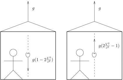

But the "inertial mass" of the whole box is its resistance to acceleration--if you try to accelerate it in deep space, photons bounce off the "bottom" inner side more often than the "top" inner side (top and bottom relative to the G-force experienced by anything in the box due to the acceleration), because the bottom is constantly accelerating towards the previous center of the box while the top is constantly accelerating away from it. Also, by the http://www.einstein-online.info/spotlights/equivalence_principle):
[PLAIN]http://physics.syr.edu/courses/modules/LIGHTCONE/anim/equv-m.gif

cbd1 said:
The gif brought a question to mind: A gravitational field accelerates all objects in it at the same rate. Does this also apply to light? It seems it could be considered as such if the light is traveling tangent to the gravitational field, for on Earth it would accelerate the ray towards the ground at 9.8m/s^2, like all other objects in free fall. However, if it is traveling straight towards the gravitational field, it cannot be as such.
Actually it does apply to light traveling vertically as seen in the accelerating reference frame where the box (or either of the rockets in the gif) is considered to be at rest. The idea that light always moves at c only applies to inertial frames, which in the context of gravity would mean a free-falling frame. In the accelerating frame, the speed of a vertical light ray does change, with the ray accelerating towards the "floor" at 9.8 m/s^2.
If you haven't read about the equivalence principle yet I'd definitely recommend doing so...

Bussani said:
So it's not that the light is being accelerated toward the ground in the sense that the light is getting faster or increasing in magnitude, but its direction can be changed, at least.
The (proper, e,g, measured locally) speed of light does not change in a gravitational field. The Schwarzschild coordinate speed of light decreases while for massive particles this coordinate speed depends on a critical speed which is [itex]c/\sqrt{3}[/itex], above this speed a test particle's coordinate speed will slow down, below it it will speed up.
