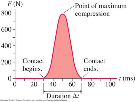

would the force acting over a period of time not be Newtons per second ( N/s )?
That would give you the rate of change of force. A typical Force-time graph looks like this:
The area under the graph gives the impulse which is the same as the change in momentum.
