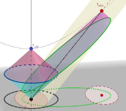

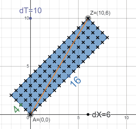

Keeping the focus on Minkowski spacetime, let's further restrict to the (1+1)-Minkowski case.
From my post last year
( https://www.physicsforums.com/threa...cle-go-through-spacetime.1048187/post-6832310 )
A way to visualize the square-interval is to draw the "causal diamond"
joining the endpoints of the spacetime-displacement vector.
For a timelike displacement, it's the intersection of the "future cone (and its interior) of the past event" with the "past cone (and its interior) of the future event".
Its area is equal to the square-interval [itex]\Delta t^2-\Delta(x/c)^2[/itex]
In the figure below, the area is 64.
So, the magnitude of the diagonal of the diamond equals 8.
The intersection of the
"future cone (and its interior) of the past event (call it event O)" with the
"past cone (and its interior) of the future event (call it event Q)"
is the set of events that "can be signaled by O, then signal Q".
So, the squared-interval of timelike-OQ is a measure of the signed-area in spacetime of such events that can be signaled by O, then signal Q.
In the null case, this area is zero... (but this doesn't mean there are no such intermediate events... just that the area is zero).
Why? (It's based on light-cone coordinates from the eigenvectors of the boost in (1+1)-Minkowski.)
The lightlike sides have sizes
[itex] \Delta u=\Delta t+\Delta(x/c) [/itex]
[itex] \Delta v=\Delta t-\Delta(x/c) [/itex]
The area is [itex]\Delta u\Delta v=\Delta t^2-\Delta(x/c)^2.[/itex]
Since the boost has determinant 1, the signed-area is invariant under boosts.
From https://www.desmos.com/calculator/4jg0ipstya
You can interact with it.
Move the events A and Z.
Since the signed-area is [itex]\Delta u\Delta v=\Delta t^2-\Delta(x/c)^2.[/itex],
  • when area > 0, then AZ is a timelike vector
  • when area <0. then AZ is a spacelike vector
  • when area =0, the AZ is a lightlike vector
For more information, consult my PF Insight:
https://www.physicsforums.com/insights/relativity-rotated-graph-paper/
You could try to generalize this to higher dimensions..
but then you'll have a more complicated expression involving the dimensionality of spacetime (in a coefficient and in a power of the spacetime-volume)
In the (2+1)-case for a timelike displacement, you'd have this 3-D volume between two cones...
but then you'd have to raise that to the 2/3-power and multiply by the appropriate coefficient to get the squared-interval.
https://www.geogebra.org/m/pr63mk3j
For a spacelike displacement in higher dimensions, one probably has to work harder to come up with an appropriate construction.
Likes Peter Strohmayer, Dale and vanhees71
