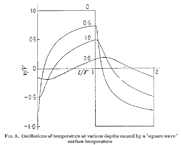

Heat flow in a solid is governed by the diffusion equation, which describes a "slow" process. An element of solid that is somewhere between surface and center begins to cool when the temperature at the surface suddenly falls (roast taken out of oven). Its heat flows to cooler volumes, namely towards the surface but also towards the cool center. This is why the center continues to heat for a short time.
To understand it mathematically, realize that all driven diffusion problems (including eddy currents) display a phase shift compared to the driving function--what happens inside is time-lagged relative to the outside driver. This is covered in all treatments of diffusion. You can certainly simulate it with a numerical code, but analytic solutions are also available. Here, for example, are plots of temperature versus time at various depths in a semi-infinite slab subjected to square-wave temperature variation at its surface, taken from Carslaw & Jaeger, Conduction of Heat in Solids, 2nd ed., 1959, sec. 2.6:
Note the phase shift--at all depths the temperature continues to rise a bit after the surface temperature falls. What you call carryover heating is most noticeable at depth "2" in this plot. Although this is a slab, similar behavior is seen in all geometries.
