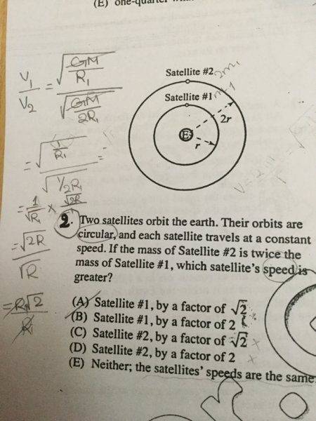

Satellite 1 has mass m1 & radius R1 and satellite 2 has mass m2 and radius 2R1
Which satellite’s speed is greater?
Question and my attempt are shown in the attached file.
V= √GM/R
I am not sure if my steps are correct, but if there’s an easier solution, I need to know it.

You are using the correct equations and you have the right answer. There is no easier solution if you are seeking a numerical answer for the ratio.
