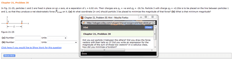

F = k*Q1*Q2/r^2
My work is E(x) = (k*Q1)/(x^2) - (k*Q2)/((L-x)^2)
Find derivative and set E(x) = 0. But I get a non real answer. Am I doing this completely wrong here? I was going to solve for x here.

I did this:
Derivative of the function F = Q1/x^2 + Q2/(L-x)^2 is dF/Dx = -2Q1/x^3 + 2Q2/(L-x)^3 = 0
Q2/(L-x)^3 = Q1/x^3 -----> Q2*x^3 = Q1(L-x)^3
Q2^(1/3)*x = Q1^(1/3)*(L-x) -----> 2.9888x = .0692 - x -----> x = .0173 m or 1.735 cm
F = 1/.0173^2 + 26.7/(.0692-.0173)^2 = 13253.59 N
I used L = .0692 m
Q1 = 1
Q2 = 26.7
Is this right? At this point I'm blank as to whether or not it is because I didn't utilize -1.6E-19 C in place of e, but rather ignored them. I guess it was alright to do that to find x in meters. But do I utilize those values now for finding the minimum magnitude F?
Edit: Now I'm really lost since I just noticed it gives Q2 as -26.7 and not positive.

You've done fine. Scaling factors that apply to all the terms of what you're minimizing or maximizing can be ignored while doing the minimizing/maximizing. Of course you have to use them in calculating the actual value of the function. Finding a minimum or maximum didn't change the physics!
Regarding Q2 being a negative charge, that was taken into account when the formula for Fnet was written; the net force from both charges Q1 and Q2 on charge Q3 is towards +x.

!.735 cm is correct.
You used ‒Q2 rather than Q2 to get that answer. If Q2 -26.7 e, then ‒Q2 = +26.7 e.
So, you're alright.
This would have come out cleaner if at the beginning, you had set:
E(x) = (k·e)/(x^2) ‒ (k·(‒26.7e))/((L‒x)^2) = (k·e)[1/(x2) + 26.7/(L‒x)2) ]
Then d/dx(E(x)) = 0  →  (k·e)d/dx[1/(x2) + 26.7/(L‒x)2)] = 0 and you can divide by k·e to get rid of it when finding the minimum.
