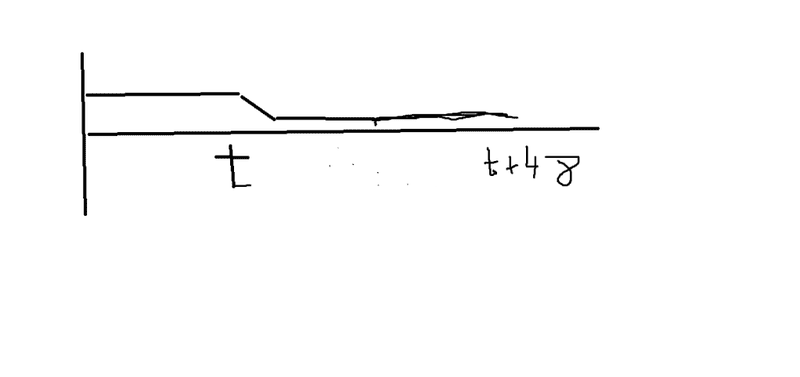

So, would the graph look like the picture i included? and Are my equ
ations correct?
PeterO said:
A picture/graph might help.
With all 5 dogs, you would have a flat v-t graph for the entire trip - ending at some time t.
For the trip with the 2 dogs running away, it would be flat at the original speed for 24 hours, then drop to 3/5 ths of that speed for extra time - finishing at t + 48
Draw those two graphs on the same axes, and you see given a common trip, the area under each graph has to be the same.
The extra 48 hours at 60% of original speed, makes up for the missing section from 24 hours to t - which amounts to 40% [the top bit] of the distance covered if all dogs had stayed.
Now draw in the third possibility - with the 5 dogs staying for an extra 50km. But that extra 50 k is done at full speed.
The distance covered in 24 hrs = only 40% of 50km.
In case you are not familiar with solving this type of problem with v-t graphs, the attached file shows you them.
I find them particularly useful.

Ok, i can understand all the graph. However, how will that give me the total distance when i do not have all the times??
From that one area value of 40% of 50 (ie 20) you can work out all the times and distances - just evaluate carefully as you go.
How did you find out that it was 40% of 50? I am not sure but basically the graph is saying that the man traveled more than 50km in the first 24 hours and than he traveled 20km?? How would i find out the area under that graph with no proper velocity?? And i have the velocity for area G and J i have the velocity but no time? Please help me read the graph
We were told the speed after the 2 dogs left was 3/5 the initial velocity, so the second, lower velocity is 60% of the first.
In graph 2, where area D = Area C, we know from that 3/5 velocity, that area C is 40% of the total (B+C)
In Graph 3, we similarly know F is 40% of the total (E+F) ; and we are told that that extra bit (E+F) is the extra 50km the full team stayed on - or could have stayed on
"if the two dogs did not escape for an additional 50km he would have reached 24 hours late instead"
That gives us the way in.
F = 20 so E = 30 also K = 20, but J = K so J = 20 and we are off. You next get H then G. You can then establish Area A [which is not a whole number!]
EDIT: by comparing areas J and K to areas E and G you can establish the time interval to t
Would G be 30 as well and H 20? I am sorry that I am not really understanding this...
Yes it is:
Here is the logic.
In Diagram 2, area D = Area C, and area D is "48hrs wide"
In diagram 3, area J is "24hrs wide", so Area K is also "24hrs wide" ; they are equal in size.
As shown in Graph 2, area B is 0.6V high, so Area C must be 0.4V high
Same height relation for E & F and G & H.
Area J and Area H have the same sized area. Area H has height 2/3 of Area J, so area H has width 1.5 times Area J. But Area J is "24 hrs wide" so Area H is "36 Hours wide". Area E is the same width.
Areas E&F together total 50 km, and are "36hrs wide". Area A is the same height, but only "24hrs wide" and thus must have area 33.333 km
Ok so the total distance is 50 + 33.333+ 20 +20 +20 = 143.333km?

You missed a bit there:
Area is [one interpretation] A + 50 + G + J = 33.33 + 50 + 30 + 20 = 133.333
ok, one more thing, how do you assume that the area of H and G equal the area of F and E if only you know that they have the same height. You don't know the widths right? Because since i know that the width of H and G = 36 and the width of F and E equal 24, wouldn't the distances be different??
EDIT: wait that's only assuming he travels 50 km in 24 hours which you can't so how did you get H and G equal to E and F?
Compare second graph to 3rd graph: Area D = J + K and Area C = F + H
Also Area F = Area K
Since D is "48hrs" wide, and J is "24hrs" wide J & K are the same size.
That means F & H are the same size, and thus E & G are the same size.
Indeed width of F is "36hrs" it is area A that is "24hrs" wide
so working along the bottom.
A is 24hrs wide
E is 36hrs wide
G is 36hrs wide
J is 24hrs wide
K is 24hrs wide
up to graph 2
B is 72 hours wide,
D is 48hrs wide
up to graph 1
t = 96hrs.
  • #31
Note that using the full team for an extra 50km, made section K 24hrs wide, not the time taken to cover the 50km.(that was 36hrs it turns out).
  • #32
Ok so area G and H are equal to area of E and F because area of J = the area of K?
  • #33
Correct! and I suspect you find it surprising - but it was all in the original information.
when the dogs left - 48 hours late
If the dogs stayed on for an extra 50km, only 24 hours late so the area J is one half of D, and thus J = K
