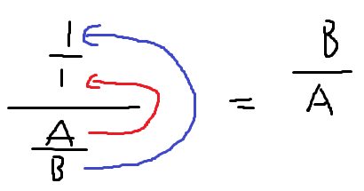

the reason why you take the reciprocal is because that is just flipping the fraction upside down. Like the reciprocal of [itex]\frac{3}{4}[/itex] is [itex]\frac{4}{3}[/itex], right? You take the reciprocal of something by dividing 1 by that number. Whenever I take the reciprocal I picture this on the paper:
where [itex]\frac{A}{B}[/itex] is the fraction that I am taking the reciprocal of
If A is calculations and B is seconds, then taking the reciprocal is going to give you seconds over calculations, or seconds per calculation.

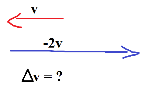

for number 3, no it's not a projectile motion problem, it is just asking about the ratio between the velocity of the ball just before it hits the bat and the acceleration of the bat as it reverses direction and doubles its speed
so basically it wants to know what acceleration would be needed to result in double the speed in the opposite direction, and the acceleration only lasts for .45 seconds. Then compare that to the original velocity.EDIT: oh and in problem 1, it's in km/h, most teachers are real sticklers about units so remember to be careful about putting down the right one ;)

Try thinking about it this way. Before the impact, what is the velocity of the baseball?
And then, what is the acceleration of the ball from original velocity to final velocity? Remember that acceleration = the change in velocity divided by the time taken to change velocity.
or a = [itex]\frac{Δv}{Δt}[/itex]
we already know Δt, so what is Δv?
here is a picture to help visualize the velocity before impact (red) and after impact (blue)
also, the ratio that the problem wants is acceleration to velocity, which means a/v

Since you put it that way. Δv=v. However, the problem states that the speed doubled plus its going in the opposite direction, that's where I got the -2.
-2v minus v = -v? Remember that Δv is (vfinal - vinitial)
