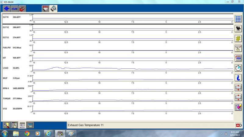

if you wanted some real numbers I could probably get you some screen shots test driving a 6.0, 6.4, or 6.7 ford diesel of the load, nm torque, rpms, and boost off of ids if you like. may not be for a couple days but I could probably get something for you to understand.
Thanks a lot, if its not too much trouble that would be nice to look at. If its a pain, don't worry about it. I have actually implemented load based torque rise in my game already, and it seemed to solve the issues i was having :) But if its really easy to share your imagery, then It's always helpful to have more data.

alright. can I post pictures here like that does anyone know or should I just screenshot them and email them to you?
if you cannot post them, my email is my username here @gmail.com. Thanks!

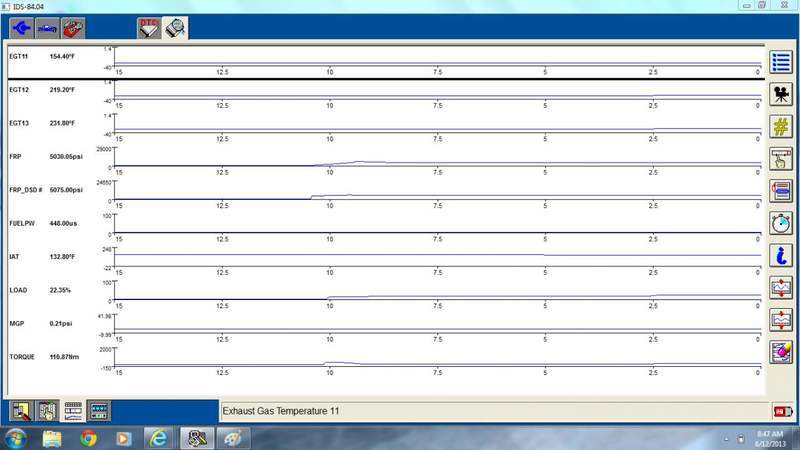

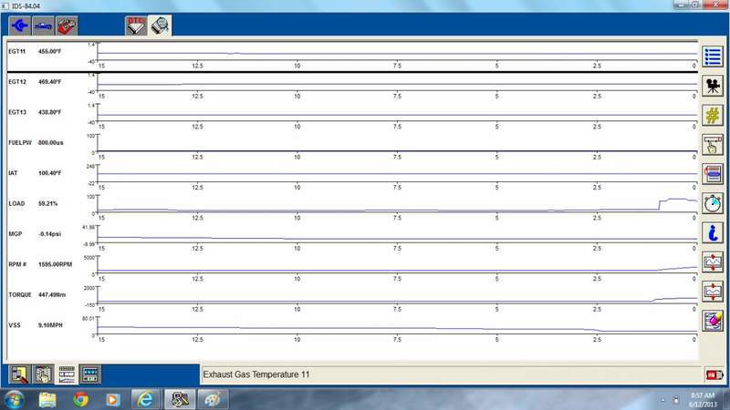

I got the screenshots this morning. its on an 09 f350 4 door longbed 6.4 auto. ill try to post them later.

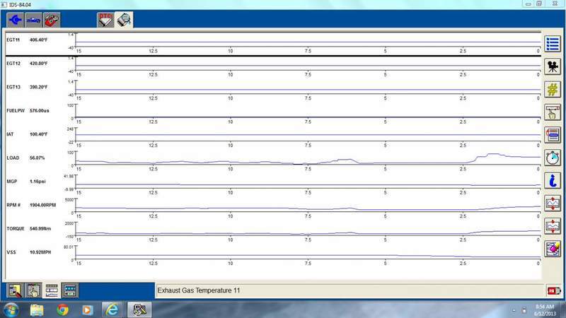

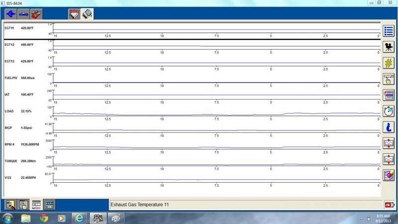

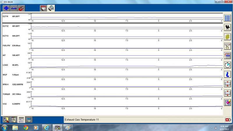

hope these work. if they do ill add some more. I don't know how theyre going to fit on here. and I just realized that the ones I took, I didn't wait long enough for the mgp to pick up on the computer. some of these pics, are right when the turbo starting to spool up good
in this second pic here. the turbo boost on the gauge and the seat dyno was around 15-20. the pid lags about 3 seconds on mgp, frp, map, etc. type pids
here are some more.
Thanks a lot 462chevelle! You have been most helpful! I can clearly see how the torque output changes with load here, confirming what you have been saying all along :).
Thanks for taking the time to post these :)
no problem, if you want some with mgp higher I can get some. I have a couple 6.4s to drive tomorrow morning
