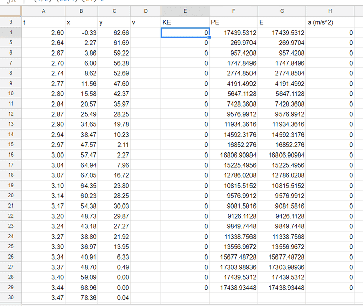

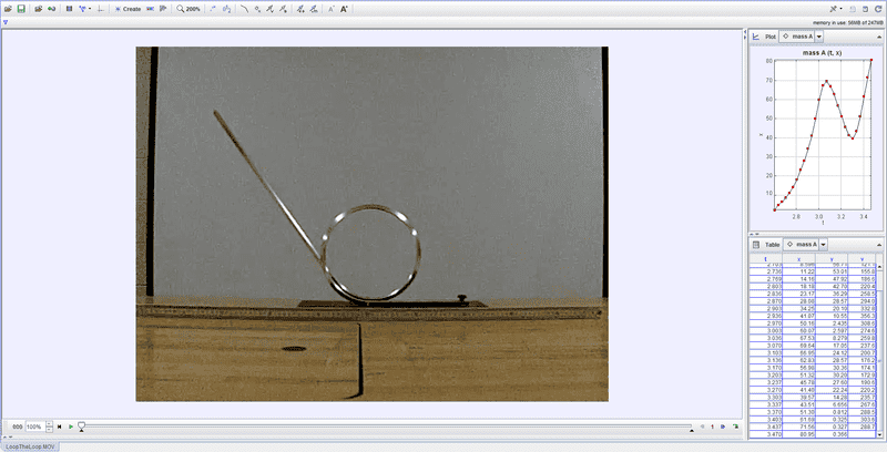

Hi guys, currently trying to figure out part of my lab for Physics I. We used the program Tracker to gather information on a metal ball rolling down a metal track and through a loop. The origin was set at the bottom perpendicular to the top of the angled track where x and y = 0. Here is the data I gathered:
Obviously to calculate the KE and PE I have been using 1/2mv2 and mgh. The ball weighs about 28.4 grams. However, I have been getting some pretty strange KE and PE numbers that don't follow the conservation of energy. I think what is tripping me up is that the ball at first rolls down an angled track and then enters circular motion. I also suspect that Tracker did not calculate the velocity correctly (those numbers seem odd to me). I am supposed to calculate the normal force acting on the ball at the bottom and top of the loop.
I at first calculated the acceleration using a=v2/r. I wanted to calculate the normal force at the bottom of the loop using Fnorm=Fgrav+Fnet. I calculated Fgrav using (m)(g) fairly easily. However, the acceleration numbers that I calculated to determine Fnet just seem odd to me, which is why I suspect that my weird velocity numbers are incorrect, thereby throwing off my KE and PE calculations. Is it possible I am using the KE and PE equations incorrectly in terms of this problem or plugging in the numbers incorrectly? Physics is not my strong suit. Thanks for the help.

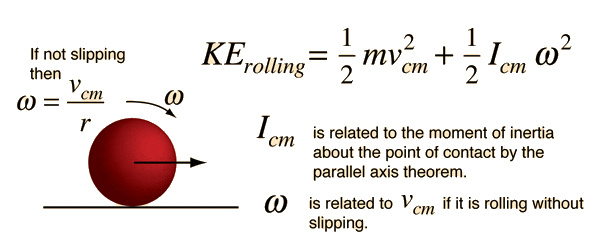

Also, the KE is not just 1/2m*v^2. There is another term you probably should be including...

Thanks, the picture helps.
As for the other energy term, here's a hint -- what would be different if the ramp and ball were frictionless?

The ball rotates when it rolls down the ramp. What is the total kinetic energy of a rolling ball? It's not just the energy from the motion of the center of mass...

Should I be using the form of KE = 1/2Iω2?

The KE should include both the linear KE of the center of mass of the ball, and that rotational KE term. You would get the ω term from the linear speed of the center of mass and the radius of the ball.
Alright, so would ω take the place of a variable in the linear KE equation, or is it just an added term to account for the rotational motion of the ball?

http://hyperphysics.phy-astr.gsu.edu/hbase/imgmec/rolke.gif

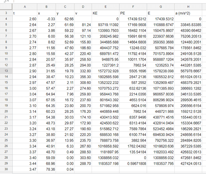

Here is my new data set. I actually had to redo tracking once more in Tracker due to scaling issues. I also discovered that Tracker provides data for kinetic energy and ω, so I used ω and the linear velocity tracker provided to determine that the ball's radius is about 0.035 meters (we weren't provided the radius in class). I calculated my own liner velocity using changes in position with time, and then calculated my own kinetic energy using 1/2mv2 + 1/2mr2ω2. The given and calculated velocities are fairly close in most regards, but the kinetic energy given in Tracker is very different at some points than the kinetic energy I calculated. The conservation of energy in the system is fairly decent, as we didn't really take into account things like friction or air resistance (those are questions for the lab write-up).

Is the column for "E" supposed to be the total Energy TE = KE + PE? The TE should be constant, to within experimental error (a few % hopefully). That E column is nowhere near constant...
ALSO -- How can ω be changing sign? The ball has the same sign of vector rotation along the path. It speeds up and slows down, but does not reverse it sense of rotation...
