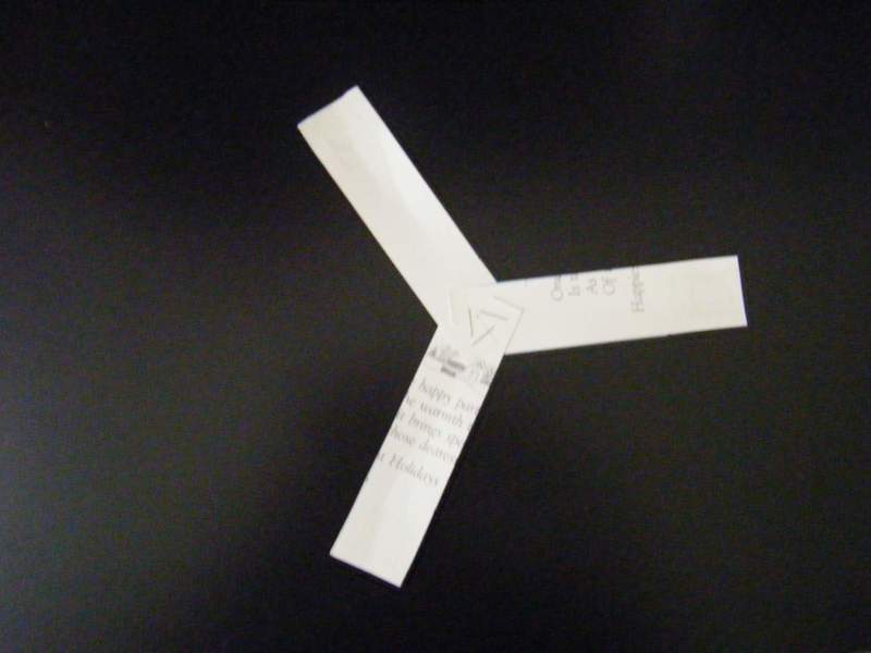

I came here because I'm doing a paper about "The Physics of Boomerangs" and so i found a topic about it where you explained a guy how to calculate the moment of inertia on a simple model of a boomerang.
https://www.physicsforums.com/threa...rtia-for-wierdly-shaped-objects.503476/page-2
However, I didnt understand the last part, about the end of the calculus. Gneill said I new = I + M.r^2 . So I use that formula 1/12 x M(a^2+b^2) and then add M x r^2 ? And after that you multiply by 3 ? In that case scenario r = 5.4 ?

The model boomerang in question consisted of three identical rectangular vanes that were arranged at 120° angle separation, and overlapped at the center (presumably glued together). Here's the picture provided by the original poster of the thread in question:
Yes that's the idea. The r had units of cm, and was, I believe, an approximation based on the described dimensions of the model boomerang. The parallel axis theorem was applied to find the moment of inertia of one vane about the center of of rotation of the boomerang as a whole. The result was multiplied by three to account for the three vanes.
The method relies on the fact that the vanes are in fact whole rectangles. If the vanes weren't overlapped and the boomerang was cut from a single sheet of material then another method would have to be found.

I calculated the moment of inertia right ? Now I want to know the angular momentum, i only have to multiply this for angular velocity and its done ?
Also, If I want to prove that the boomerang returns using this calculus what would you counsel me to do ? Adding torque calculus would help ?
Yes.
I fear that proving that a given boomerang returns, or simply determining any part of its trajectory would be a much more difficult problem involving aerodynamics. Angular momentum would be just a small factor in a much larger problem.
