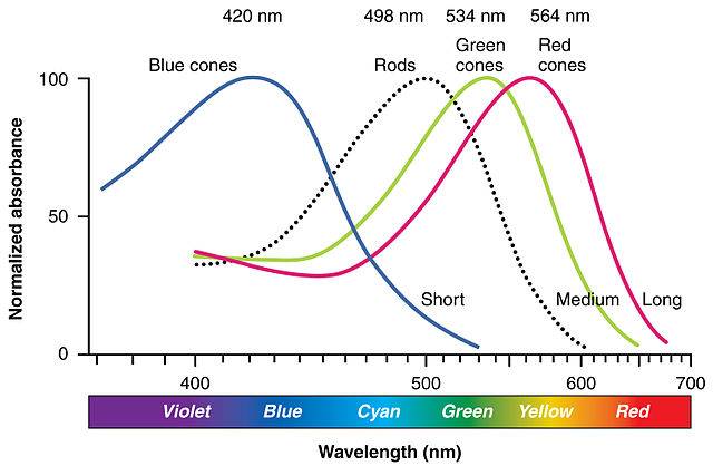

Here is wikipedia's "normalized" response chart for the cones and receptors in the human eye. It is "normalized" in the sense that the peak response for each type of cone or rod is set to 100:

The colour is not the light/photon energy it is the interaction with cones in the retina as per Scotts post #2

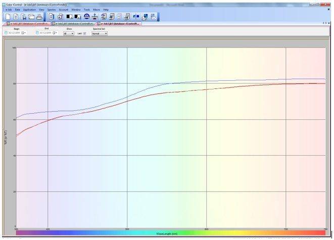

Nice picture. What does it show ?

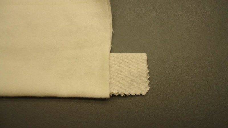

I took a measurement of yellow textile samples and that is the reflectance data for the measurement
The curves are quite flat with no real peak at 650nm it mainly flat with similar % near 700nm, the actual physical samples look like the below. You can make some good guesses on actual colour from RD but some curves do not look what yo

Apologies that post flipped out. Yes some curves appear to make sense but others have peaks where you would not expect.

Thank you, very nice experiment, but I think blackbody radiation (sun) and reflection from some real object is a another story.
But also very interesting.

What peaks would you expect? Reflective surfaces can have virtually any wavelength response that you care to think of and many different responses can produce a matching 'colour' response in the observer. Trying to use perceived colour as a measure of anything is likely to cause problems - except in a taylor made experiment where colour matching has already been validated.

Yes - I would add that it is the combination of the three sensor outputs that gives a particular colour sensation / match.
There are really two issues here, though.
Firstly, we can't equate colour and wavelength (only wavelength with colour - in that direction)
The perceived colour of a hot black body is due to the three sensors and that colour is extremely de-saturated so the photon energy variation over the whole spectrum will not have the same effect on perceived colour of a monochromatic source. I seriously doubt that the eye could perceive any difference between the perceived colour of a hot source and a monochromatic source with only approximately the same wavelength as the measured peak of the black body spectrum. (Colour resolution is hardly better than 1%)

indeed ... I took the risk and did what @pinball should have done :wink: ...
screen dumped from his PC screen to a graphics prog and saved as a xxx.jpg file, then uploaded
like this ...

I take it that you are implying that my method will produce poor resolution. Any screenshot will have a resolution that's no better than the original screen image and, as we'd expect, in your sample, the labels are illegible. The point about PDF coding from an original Document that's been produced by a 'legit' method for possible zooming or printing is that the resolution can be whatever you want. Look at any Data Sheet or Learned Paper and you can print it at full (300+dpi) res. In my experience, when saving a Word document in pdf form, you get a printable image, even with a pretty small pdf file.
Also, JPEG is not the best bit reduction method for 'line' images; it was developed for pictures and the artefacts are pretty dreadful when text is involved, however acceptable the rendering of a 'photograph'.
Do some experimenting yourself and you can compare the various forms of compression for the various forms of source file. Screen shot is probably the worst way to do it - in the same way that MS Paint was probably the worst way ever invented, to draw diagrams :smile:.
