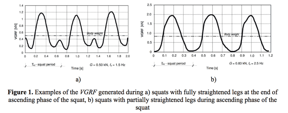

I wondered if someone doing a pushup (or squats) might decelerate more linearly in order to minimize the force. But apparently I was wrong:
https://iopscience.iop.org/article/10.1088/1757-899X/245/2/022053/pdf
Likes A.T.
that paper was very helpful in understanding this was a way more difficult question to ask than i had previously thought. thank you
