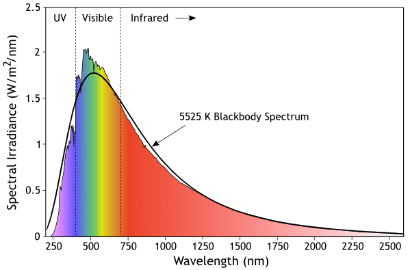

Hi,
I am doing my dissertation for Mechanical Engineering on Solar Stills and my mentor has suggested it would be a good idea to research the physics of light/infrared absorption, transmission, water evaporation and condensation. I am wondering if anyone has good book recommendations for me to look at so I can best understand the sciences to optimize my design.
I'm not too sure how in depth it would have to be but most of the links I've found are directed towards around GCSE level in the UK which I'm guessing is not enough information since after reading it all it just seems to be very surface level, but I don't want something so complex I can't understand it myself as an engineer.
Thanks a lot and I look forward to the replies.

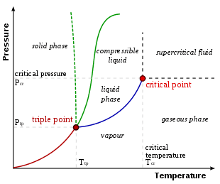

For example, diagram phase might be interesting! Though, you might be totally unfamiliar with:
Or the fact that the sun spectrum diagram is not uniform. This also means that you can harness more or less energy depending on the domain of light you are interested in:
Are these familiar things to you? or are they new?
- If they aren't familiar, start from these subjects and you will find good sources. If you are familiar with them and don't find them helpful, you might want to specify a bit.

Thanks Tom.G that's a good link for me to add and use. I have seen similar information in other scientific papers I have been looking at.
In regards to Phylosopher, I have seen the phase diagrams in my class but I'm not sure how relevant that is for me so I'm guessing I need to brush up on phase diagrams. I don't see it being useful currently? What do you have in mind me using this for? The second image was a pretty good point for me to think about however I didn't know that it's not uniform so this gives me another route to look down thanks a lot!
I was not sure whether that would be helpful, I am happy it did give some ideas. I think discussing ideas is better than discussing what textbook to read at your position.
Well, a still uses vapor. You can raise the temperature to/above 100 C for example, or you can lower/raise the boiling point by changing pressure.
This might be silly thing to do for an engineer, I don't know really. I am just a physicist, but I think it might be useful.
