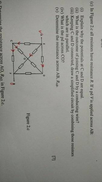

In the fig all resistors have resistance R. If pd of V is applied across AB.
1)What is the outcome of joining C and D
2)Whats is the pd across CO
3)what is the resistance across A and B
4)What is the resistance across AO

1) i thought that it would cause a short circuit because instead of flowing through the resistors co &od it would directly flow.
2)?
3)?
4)?
What would flow from where to where? You are connecting C and D, not E and F.
what is the potential difference between C and D
zero
So i understand that between C and D no current flows. So there is ans for 2)no change right ?
yup :)
so is the current direction i marked correct ? and does current flow from o to d or d to o ?
you won't know unless you know the resistor values... the real question, does the current direction you pick matter?
As currents can be negative, you can draw the arrows in any direction you like. One direction will lead to positive current, one to negative current - unless the current is zero of course.
Correct. How did you figure that out? A proper description will help with the next part.
