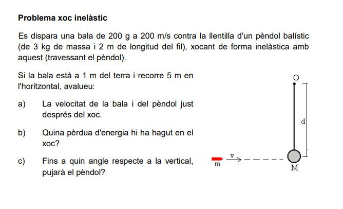

A bullet passes through a ballistic block and making an inelastic collision
Energy equations, parabolic equations(?), momentum equations.
Does anyone know how to solve this problem? I translate the full statement:
A 200g bullet is shot against a ballistic block passing it through and making an inelastic collision. The initial speed of the bullet is 200meters/second, the mass of the block is 3kg and the string that holds the block measures 2 meters. The bullet is at 1m of the floor and travels 5 meters in the horizontal axis.
a) What is the speed of the bullet and the block right after the collision?
b) What is the lost energy in the collision?
c) What is the maximum angle that makes the block ?
I don't require the full answer, just an algebraic proposal is enough
(sorry for my english, I'm not native speaker)

My guess is that the mass of the bullet should be ##20g##. That changes things.

The bullet has to go through the block. The string holding the block is 2 meters, and the bullet travels 5 meters in the horizontal direction. The block has only a maximum possible horizontal travel of +/- 2 meters.
Also, if it travel 5 meters in 0.45 seconds, how fast is it moving?
And 200 grams is way heavy for a bullet. It's kind of heavy for a crossbow bolt. But if it is the value in the problem, it is the value in the problem.
haruspex said:
The horizontal distance of 5m may be just there to confuse you. It cannot be relevant. You are not asked to allow for drag, and in the collision only the horizontal momentum matters.
I assumed that was after it exited the block: ##5m## horizontal and ##1m## vertical determines the exit speed of the bullet. But, it does seem odd to add that to the problem.
