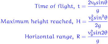

TIme of Flight= 2v0sinθ/g and Horizontal Range=v02sin2θ/g
Looking at both the equations, it's easily concluded that by increasing v0 both Time of Flight and Horizontal Range will increase.
Not the tricky part is with θ.
For the given value of v0, Horizontal Range at θ and 90°-θ are equal although the time of flight is different. Why?
Because in the equation of Horizontal Range, we have sin2θ and you can check that value of sin2θ for θ=30° and θ=60° are same. Hence if v0 is also constant, then Horizontal Range for θ=30° and θ=60° will be same. So it's now clear that increasing θ will not increase Horizontal Range forever.
So out of the options present, I'll put my money on Option. C

If that’s right. Then, by only increasing the initial velocity, time and range would increase.

You’re definitely right. I was finally able to recognize this at the end. Thank you all for your efforts...

By the way, I would have preferred for the OP to realize that when we plot ##\sin(2 \theta)## from 0 to 90 degrees (the range of possible angles ##\theta##), the value of ##\sin(2 \theta)## increases as ##\theta## goes from 0 to 45 degrees but then actually decreases as ##\theta## goes from 45 to 90 degrees. So as long as the angle is below 45 degrees, we gain in range by increasing it, but past 45 degrees, we start losing in range. So the optimum angle for the range is 45 degrees. This is was I was aiming at with my guiding questions.
