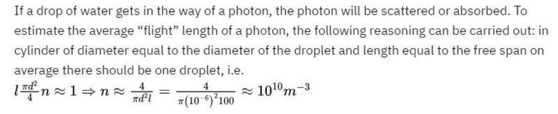

@pasmith @haruspex @Chestermiller I have just found what is supposed to be the solution to this problem. I attach it at the bottom of the page.
It considers the diameter instead of the radius, so it conforms to the solution with K=1 advanced by @Chestermiller and @pasmith. What do you think? Thank you.

It makes the untrue assumption that the visibility distance is the same as the mean free path. At the mean free path distance, the probability of any given photon making it all the way is ##e^{-1}##, so more than a third of the object would be visible.
