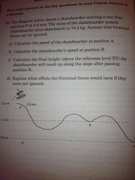

Question:
answers so far ( i don't know if its right that's why I am posting on here)
please let me know if I am doing it correctly thanks ! :smile:
also i have no idea how to do c! at all !

For part c, I don't see the rest of the pic after B. If it starts at 2.5 m, though, above the reference plane, where must it end up before it stops, without friction, using the same equation?

The skater starts off with an initial speed of 2.6 m/s^2 at a height 2 .5 m above a reference plane. For part a, at point A, the skater is 1.5 m above ground at some speed. The delta h is -1.0 m. But be consistent in setting up the energy equation. Either use initial KE plus initial PE = final KE plus final PE, where the initial PE is 2.5mg and the final PE is 1.5mg, or use the "delta" formula I referenced, where the change in PE is (1.5mg - 2.5 mg) = -1.0mg.
