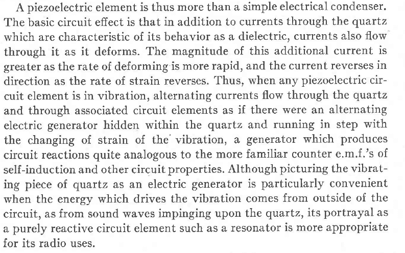

That's great insight on oscillation mechanics, thanks. I found another resource this time titled "the piezoelectric quartz resonator" p216 (attached):
This description of the reverse current effects of the piezoelectric stress-and-strain (to produce AC) is what I was curious to learn about...I don't think this can be caused by acoustics because it necessarily involves an electromagnetic effect...I'm wondering if the current flow through the crystal causes the crystal vibrations, and are ultimately the effect of simple harmonic motion from the elastic collisions of the current's electrons with the crystal atoms' dipole radiation field? How else can self-induction be explained in a piezoelectric material?
I think you are over thinking it and incorrect.
I've done tests where a short pulses drive a 4 MHz crystal. These pulses are issued at 10s of kHz rep rates. Each pulse is much shorter (5 to 10 ns) than the 250 ns crystal period. The Q-value is such that the ring down of the crystal is quite long, much more that 100 crystal cycles between pulses. This signal voltage between drive pulses is generated by the free vibration of the crystal mass and the piezoelectric nature of the crystal material.
The coupling between the crystal vibration and the drive voltage is weak. In these tests, the frequency of the pulses must accurately match a sub harmonic of the fundamental mode in order that sufficient vibration is induced.

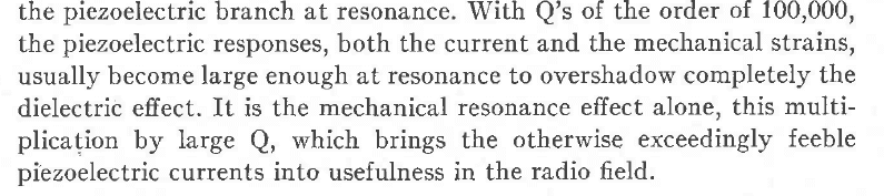

I see. And the author is in agreement with you - that it is a mechanically resonant - dominant behavior. From p220 of the previous attachment:
So the elastic collisions from the current cause mechanically stored potential energy (hence the resonance) which can operate as a frequency-selective filter. But can this mechanical resonance cause a 360 degree phase shift, i.e. simple harmonic oscillation, to a DC driven-input? Isn't this one type of useful application?
I don't follow. At DC a typical AT cut resonator looks like a 2pF capacitor or so. All this follows from the RLC equivalent circuit. You seem to have some fixation with elastic collisions? My suggestion is read the references. Mechanically there are the Hook's law potential energy (associated with the C) and the vibrational kinetic energy (associated with the L) all weakly coupled to the applied field (associated with the applied sinusoidal voltage).
