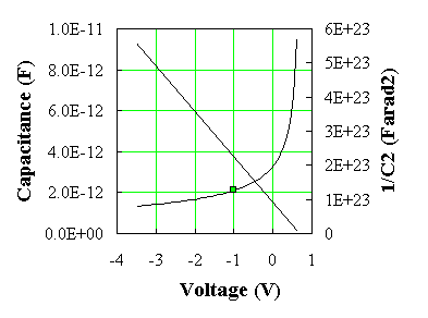

What I cannot wrap my head around is why there is no capacitance (negligible) when the PIN device is forward biased. I would think that forward biasing the device reduces the depletion width, thereby increasing capacitance. In a pn junction device, there is an equation relating forward voltage bias to capacitance caused by diffusion.

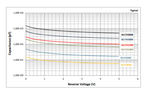

What's even more confusing is that following the trend of PIN photodiodes in datasheets, capacitance INCREASES as reverse voltage bias is decreased. I would think that this trend would continue into forward bias, but I cannot find any datasheets describing this. See below datasheet for an InGaAs PIN photodiode.

Thanks for your response. This makes good sense, but I'm confused on why we can no longer use a parallel plate model to model capacitance as is done in reverse bias. If the depletion width gets smaller, shouldn't the capacitance get larger according to the parralel plate model because the area is shrinking? We see this effect in pn junction diodes below.

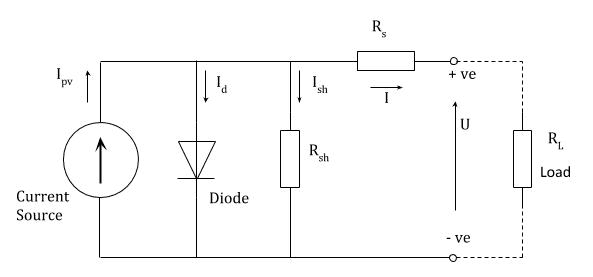

I am worried that attaching a filtering capacitor would add a large capacitance in parallel with the oscillator. This would increase oscillation period, which is undesirable. In the circuit diagram below, you can see that the load acts in parallel with the current from the photo diode. It seems like a capacitance also acts in parallel, but can be negligible.

1. The schematic you provide shows a symbolic model of a forward biased PV diode. Is RLoad in your circuit where you connect the oscillator module ?
2. Is the frequency of the oscillator module fixed, or is it supply current dependent? A fixed frequency oscillator takes Q cycles of time to begin oscillating. We need to know Q.
3. What output voltage is expected from the PV module? Are there many PV diodes in series, or is there only a very low voltage available to run the oscillator module. I would like to know how the oscillator module can operate on such a low supply voltage. I suspect it would need to be some form of tunnel diode oscillator.
4. The supply current requirement for an oscillator is time dependent and repeats every cycle. I assume the current you measure when testing the oscillator on a fixed supply voltage, is the average over a full cycle. An oscillator that runs on a low impedance fixed supply voltage may not operate when connected to a high impedance current source, as it may short circuit itself once every cycle.
A schematic for the oscillator module is needed before it can be simulated as a load being supplied with current from a photodiode.
There may be some possible modification to the oscillator circuit that will allow it to operate from the high impedance PV diode without a long start delay.
5. If you asked the right question, you could answer it. Without an oscillator schematic we cannot identify the question you should have asked.
