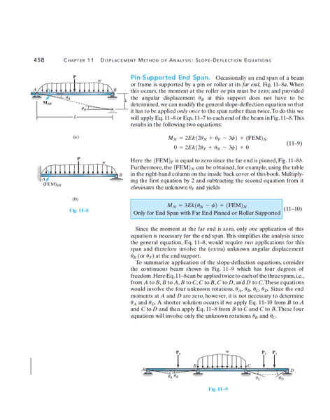

In this question , is figure 11-2 a and 11-2 b the same beam ? Why in a , the support is pinned end , it change to fixed end in figure b ?
In equation 11-9 , i gtet different ans with the author ..
Here's what i gt :
MN = 2EK( 2 θN + θF - 3 Φ ) + (FEM)N
So,
0= 2EK( 2θA + θB - 3 Φ )
At here θA = 0 , and (FEM)N = 0 , far end = B ,near end = A
MN = 2EK( 2 (0) + θB - 3 Φ ) +(FEM)N ----(1)
0= 2EK( 2θB + 0 - 3 Φ ) ------(2)
By applying the same method as author ( Multiply equation 1 by 2 , and subtract equation 2 ) , i gt
MAB = 3EK(-Φ)
No. They are the two different cases of "far end not fixed" (i.e. pin or roller). The near end is fixed or not fixed.
I cannot follow your algebra. You seem to be setting some things to zero without cause. I get the same equation as the author.

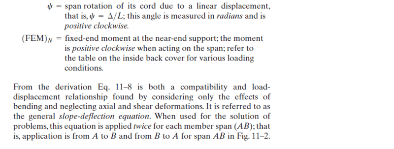

why in case 11-8(a) , the far end angular dispalcement theta _B doesn't have to be determined ? I only learned that when the end is fixed support , then , the the angular displacement is 0
θB (=θF) does not need to be determined because it was possible to combine the two equations so as to eliminate it and produce an equation without it. There is no suggestion that is zero.

In 11-8 a, we could see that at the left end , it's pin supoorted , why at 11-8b , it will become fixed supported ?

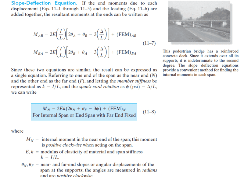

Can you explain how to get 0 = 2Ek( 2 theta_N + theta_F -3phi) + 0 ? (Just below equation 11-9)
The left end is the "near end". The situation being considered is "far end not fixed". There are two cases of that, near end fixed or near end not fixed. Hence the two diagrams.
Apparently this comes from Eq 11-7 and/or 11-8, but those are not in your post.

fonseh said:
Here is it . Can you help to explain ? 0 = 2Ek( 2 theta_N + theta_F -3phi) + 0 ? Does the first 0 represents MN , and the last 0 represent (FEM) N ?
Yes, but remember this is applying eq 11-8 at B in fig 11-8b, so in the context of eq 11-8, B is the near end and A is the far end (which is fixed in fig 11-8b). (The unfortunate coincidence of similar reference numbers in eqs and figures is confusing.)
Likes fonseh
then , how about MN = 2Ek( 2 theta_N + theta_F -3phi) + (FEM)N ? What does it represent ? 11-8a ? Which is near end ? and which is far end ?
That is the other way round, A is the near end here.
Likes fonseh
So , both MN = 2Ek( 2 theta_N + theta_F -3phi) + (FEM)N and 0 = 2Ek( 2 theta_N + theta_F -3phi) + 0 describes about case in 11-8b ?
No. Compare your second equation above with the second equation of 11-9. The angles are swapped around.
I think what is confusing you is the near-far notation in eqs 11-9. In both of them, the near end is A and the far end is B, so for clarity rewrite them replacing N with A and F with B everywhere.
Eq 11-8 is for far-end-fixed. The author doesn't write it out but states that if, in addition, the near end is not fixed we can simply substitute MN=(FEM)N=0 in eq 11-8. Call this eq 11-80.
In fig 11-8b, we have A fixed, B not fixed. This means we can use eq 11-80 with A as F and B as N. This gives the second eq of 11-9. We can also use eq 11-8 but with A as N and B as F. This gives the first eq of 11-9.
Likes fonseh

why if the near end is not fixed , we could use MN=(FEM)N=0 ??
We can notice that the case in 11-8b yield equation (11-10) , so , is it possible that the equation 11-10 to be used and applied in case 11-8(a) in which both ends are roller / pin supported ?
Because a pin or roller cannot exert a torque.
