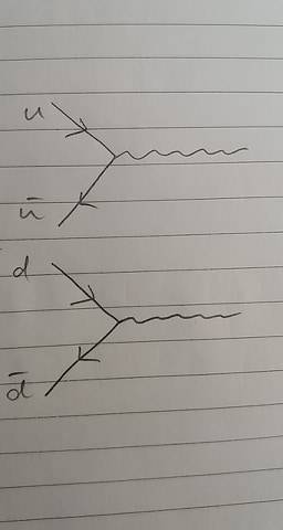

Yes, the pi plus is an up and an anti down, and anti up and down for the minus. The only way I can think to draw that is with the down and anti down annihilating into a photon and same for the up and anti up? I'm not sure if there's a way to do it as one diagram?
Likes vanhees71
That is one diagram.
You can connect some quarks with a gluon if you like.

Um, so far I have this? Is this what you mean?
I would start the diagram with the individual pions as groups (first the two quarks of the pi-, then the two quarks of the pi+, or vice versa), even though that means two lines have to cross.

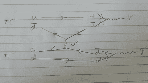

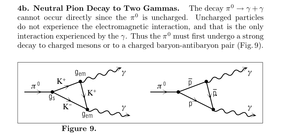

Right. Where the lines cross, I assumed another interaction happens? I found this while on a googling rampage
from https://physics.stackexchange.com/questions/235366/feynman-diagram-pi0-pi0-rightarrow-pi-pi
If this person is right (I am far too inexperienced to tell that as is clear!) then by rotating this through 180° gets another valid diagram. Now, if this is all true, can the quark-antiquark pairs annihilate into a photon each, or do the π0s decay into two photons each like this?
No. The position of the lines is largely arbitrary and crossing lines don't mean anything.
There is no weak interaction here.
Likes Physicsphysics

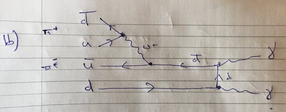

After some discussion, this was the conclusion... Is this correct?
Are you reading what we write?

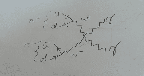

Is this a possible solution
You were closest with this. But you didn't start with the quarks grouped into the pions as mfb said in post #7. You don't need any more lines.
