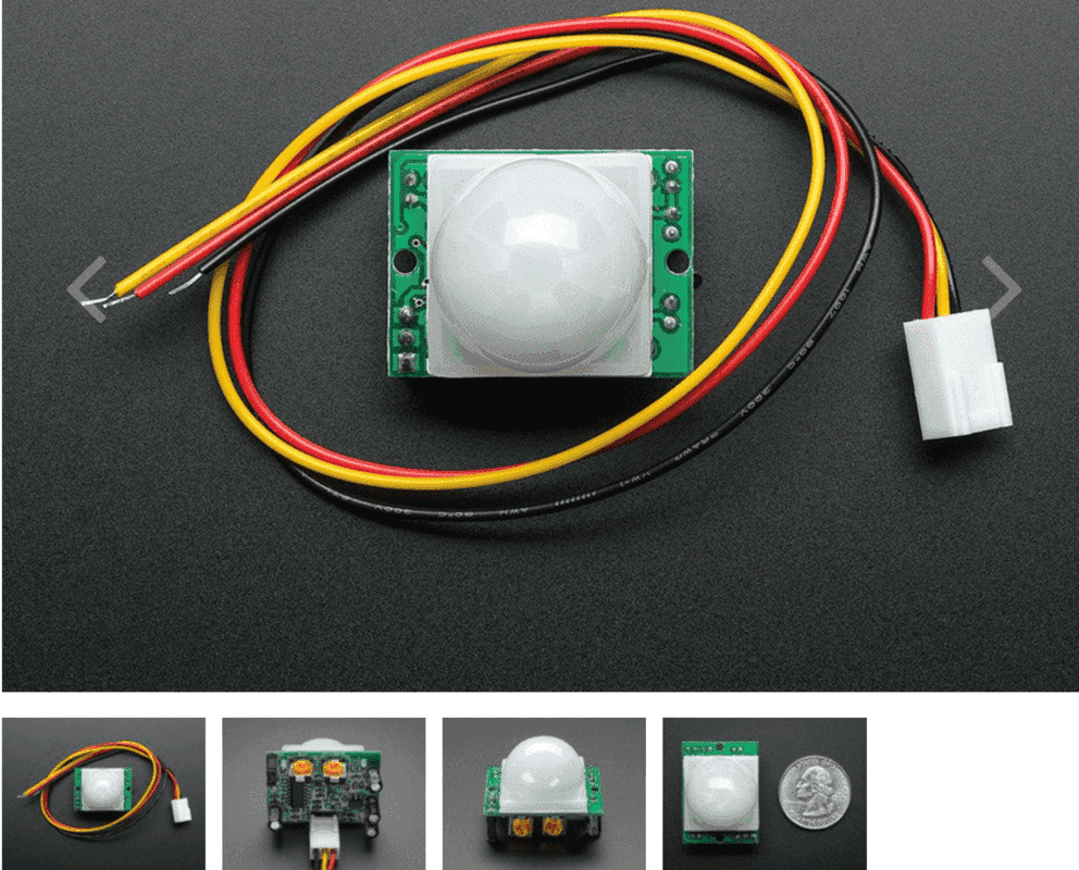

I am using a Raspberry Pi with a PIR motion sensor and a Pi Camera. The idea is that the camera should take a picture every time the PIR sensor detects motion. The system works but it does not respond, i.e. take a picture, as fast as I would like if I wave my hand in front of the PIR sensor...
Any idea why? Ideally, I could just wait a second, wave my hand in front of the sensor, and have the camera take a pic. But it does not happen? Any idea?
Should I use a distance sensor instead?
Thanks!

Which PIR sensor are you using? Does it have an LED indicator that flashes when it detects a change? If so, is there a delay in the LED flash compared to what you expect, or a delay in the notification of the Pi after the LED flash?
Most PIR sensors use refracting lenses to detect any motion of IR sources. Does your PIR sensor have that, or is it simpler?
Likes fog37

I am using this one:

(possibly works on zombies, not guaranteed). This one has an adjustable delay before firing (approx 2-4 seconds),
Are you testing it with Zombies? It looks like it's not guaranteed in that use-case... :smile:
It looks like the delay "feature" might be an issue? I don't see an LED output to indicate firing, unfortunately...
EDIT/ADD -- I just tested my room PIR sensors (that light nightlights), and the LEDs blink within about 100-200ms of motion being detected and the nightlights lite with that delay (plus some ballast delay). I think you just need to pick different PIR sensors that don't have a minimum delay of 2s.
