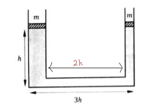

A U-shaped pipe is sealed by two pistons of mass m. Initially, both pistons are held such that the heights of the air columns in both branches are h. Cross sectional area of left branch is 2S, right branch's is S. The initial air pressure in the pipe is equal to atmospheric pressure p0. Then both pistons are released, find the heights of both pistons when they reach equilibrium. Supposed that the temperature of the air inside the pipe remains constant.
F/f=S/s;...
I have tried using Pascal's law for the pipe but it turned out that the law only works for incompressible fluids, whereas this pipe contains air, which is compressible. I thought then this problem might be the same as one with a cylinder containing air sealed with a piston, but there might be some things I've missed out.

Do you know how to complete and show to us a free body diagram of each piston?

Thank you for asking! I figured out that the air pressure inside the pipe must be constant such that its volume remains constant in order for Pascal's law to work.
That is a good first step.
But each combination of mass-piston induces a different pressure in the gas below it.
Therefore, after both pistons are released, each will naturally slide to a new height in order to reach equilibrium.
Could you calculate each of those heights?
What value that equilibrium pressure will be?
  • Wow
Likes highschoboy004
I can't help thinking that since both pistons have the same mass m, their weight should cancel each other when equilibrium is achieved, keeping both pistons at the initial height h.

But are they subject to the same forces?

What forces act on each?
I think there are two forces acting on each piston: their weight and the fluid's force. I'm asking about the latter force.
You are given the cross-sectional area of each piston. What is the formula for the fluid's force on each?

That is the reason to draw a free body diagram, whenever possible.
We have symmetry of masses and their weights, but not of piston's areas.
##P_{right}=F/A=mg/S##
##P_{left}=F/A=mg/2S##
Now combine that concept with your correct statement in post #4:
"I figured out that the air pressure inside the pipe must be constant such that its volume remains constant in order for Pascal's law to work."
Then, we conclude that one of the above equations must be incorrect, since we can only have one unique air pressure underneath both pistons.
Which one would it be?
Which mass would not be in equilibrium with the upward pressure-induced-force of its piston?
