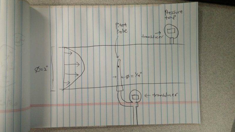

Would you mind perhaps drawing a picture of your setup just to make it more clear to everyone? It would probably prevent some of the confusion here.
Ok so I am in agreement here with everybody that using the probe in a 3/8" ID pipe is probably not best so I will no longer be using it in there, thanks for the advice. So yesterday I ran the tube in the 2" ID pipe yesterday (picture of setup attached) and I did see a very small difference using highly accurate pressure transducers (all calibrated). When the hole was normal to the flow, I read an average of 50.0975 psig. When parallel to the flow I read an average of 50.080 psig. However, using bernoulli's equation for incompressible flow (v = sqrt((2*(p0-p1))/rho) I still am only getting about 2.5 ft/s. So yes I am getting a slight difference, but I know I should be reading more. I did not attach a flow meter to my setup as another engineer was using it, so I do not have a volumetric flow rate to compare to, but I can guarantee the flow is moving MUCH faster than that (we had to wear ear plugs).
PS. in the picture, flow is fully developed with no bends or changes in the pipe upstream or downstream for at least 20 pipe diameters.

So I do have a couple more comments. First, assuming that your probe protrudes 1.25" into the pipe (1" to get the hole into the center and another 0.25" since the hole can't be at the end of the tube), then the probe is still going to be blocking 10% of the area of the pipe, so it will definitely still cause the flow to accelerate just by being in there.
Second, let's assume for a second that your probe is just hanging out in a wide open area with no pipe to worry about. If the air is moving toward it at some velocity ##U##, then the velocity parallel to the surface of your tube at the surface is going to theoretically be
[tex]v_{\theta} = -2U\sin \theta,[/tex]
where ##\theta## is the angle around your probe (starting at zero on the right horizontal and measured counterclockwise). This is using potential flow theory, so it isn't perfect, but it's a decent estimate for the time being. In other words, over the top of your probe, the magnitude of the flow velocity is going to be roughly twice that of your incoming free stream. The flow should still stagnate at the front end, but the problem is that your hole that you are using as a pressure tap is not infinitely small, so it is measuring more than just the tiny bit of flow at the stagnation point.
If your tube OD is 0.25", let's assume the hole you drilled is 0.125". That means that your hole is going to take up 60° of the circle. Using that, we can average the velocity you are actually measuring. First, look at the "stagnation" condition. The relevant problem here is integrating the velocity ##\pm \pi/6## about the measurement point to find the average (this is just in one dimension, I haven't even considered the second dimension of the hole). So, getting the average velocity of the flow over your hole is just solving
[tex] v_{avg} = \dfrac{2U}{\frac{7\pi}{6} - \frac{5\pi}{6}}\int\limits_{5\pi/6}^{7\pi/6}|sin\theta|\;d\theta \approx 0.512 U,[/tex]
where I've taken the absolute value since we are looking to average the magnitude here. You are therefore measuring nearly half of your free stream velocity there, not stagnation. Doing the same thing for your "static port" configuration is solving
[tex] v_{avg} = \dfrac{2U}{\frac{2\pi}{3} - \frac{\pi}{3}}\int\limits_{2\pi/3}^{\pi/3}|sin\theta|\;d\theta \approx 1.910 U,[/tex]
so you are measuring nearly twice your free stream velocity there. In other words, you shouldn't expect these to measure what you are hoping they will measure. I don't particularly feel like working out the double integral to get a more accurate estimate based on two dimensions, but it will tend to make your static port worse and your stagnation port a little bit better. Either way, it's not a good design.
So Boneh3ad put some math to show you what I mentioned above you are not properly measuring static pressure because of flow over the cylinder. He showed that this is not a minor error that can be ignored and it is probably much worse than the simple potential flow theory would indicate because of the additional acceleration due to the size of your probe relative to your pipe.
Most static pressure probes have the axis of the probe aligned with the flow in order to reduce the effects of the flow acceleration over the probe. In addition this also reduces the amount of blockage that the probe generates. You really should change the design of your probe.
I also want to point out that your calculation of velocity from the pressure difference is probably incorrect. A dynamic pressure of nearly 0.02 psi is closer to 50 ft/s. My guess is that you are using density in slugs/ft^4 but pressure in lbs/in^3. You need to convert psi to psf or convert your density to slugs/in^3.

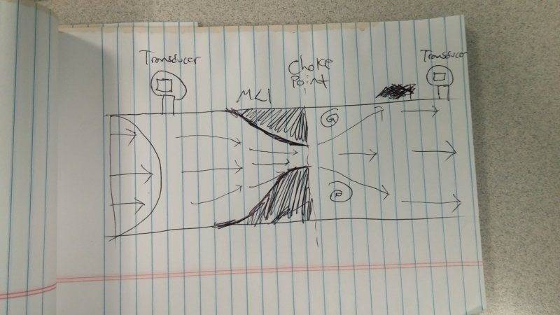

So the problem with using the static pressure at the wall is that in the scenario I am going to be testing, there is a re circulation point at the wall which will give me an inaccurate reading, hence the need for this probe to measure both static and total pressure.
Why is there a re circulation region on a straight wall?
The test setup I have now (or in the drawing a few replies back that I posted) was only in place to ensure the integrity of my pitot probe. Basically, I was just trying to see if my pitot probe would work or not, and now I know it does not so I will be changing my design.
In the application I need to use the probe, the cross sectional area of the pipe is changing. It is essentially acting like a converging diverging nozzle and making the flow go supersonic, and I have attached a drawing of what is happening on a basic level.
I need to prove that the flow is going supersonic after the choke point, and after proving this, stop the flow from going supersonic. I have a design ready to implement to stop the supersonic flow, however proving the flow is supersonic is another matter. Normally this could be solved using a combination of wall static pressures and stagnation pressure from a pitot tube, but in this case, actually getting the probe into the setup with the tools I have at hand and without drastically altering the product I am trying to test is causing a huge problem.
Long story short, I need to prove flow is supersonic and getting a pitot probe inside the flow at any point in the setup is very difficult in the best case.
Also, in the drawing I provided, I cannot measure the critical area at the choke point either.
