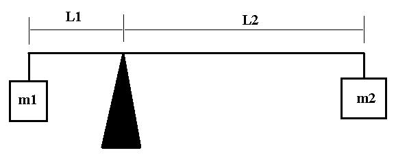

A beam is supported only at one point, called the pivot point, as shown in the diagram. A block with mass m1 sits at the left end of the beam, a distance L1 from the pivot point. A block with mass m2 sits at the right end of the beam, a distance L2 from the pivot point. L2 > L1. Calculate all torques about the pivot point, remembering that positive is anti-clockwise.
Select Yes, No, Less than, Equal to, or Cannot tell.
  • Given particular values of L1, L2, and m1, is it always possible to choose m2 such that the masses have no angular acceleration?
  • If m1 * L2 = m2 * L1, is there a negative torque?
  • For m1 = m2, does the angular acceleration depend only on L1 / L2 ? (If it depends on the actual values of L1 and L2, put 'no'.)
  • If m1 * L1 = m2 * L2, will the masses have an angular acceleration?
The diagram is not show, attach it, please!
ehild
here is the attached image that came with the problem.

[*]For m1 = m2, does the angular acceleration depend only on L1 / L2 ? (If it depends on the actual values of L1 and L2, put 'no'.)
  • I'm really stuck on this one... I put no, since the torque is calculated from the sum of the each individual torque, not the product nor the quotient.
  • "NO" is the correct answer. You know that the angular acceleration is torque/moment of inertia. The moment of inertia is m1L12+m2L2 in this case.
    The angular acceleration is
    [tex]\alpha=g \frac{m_1L_1-m_2L_2}{m_1L_1^2+m_2L_2^2}[/tex].
    When the masses are equal they cancel, and the angular acceleration becomes
    [tex]\alpha=g\frac{L_1-L_2}{L_1^2+L_2^2}=g\frac{L_1/L_2-1}{L_2(1+(L_1/L_2)^2)}[/tex]
    it depends on the actual lengths, not only on their ratio.

For the second question, I just noticed that L2>L1 was given. You can find out if the torque is negative or not.
It says that m1L2=m2L1, so m2=m1(L2/L1).
Substitute for m2 in the equation for the torque and see what you get with the condition L2>L1.
ehild
Could you please see if the following is correct?
Torque1 = m1*L1
Torque2 = m1*(L2)2/L1
Since L2 is greater than L1, then Torque2 is greater in magnitude than Torque1, and since counterclockwise is positive, there is negative torque.
YES!
ehild
