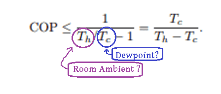

That's an interesting thought.
Carnot efficiency is indeed favored by lower exhaust temperature
the closer Th and Tc the smaller the denominator
So if by 'efficiency' one means pints of water condensed per kilowatt-hour of electricity consumed
that's the right answer
at least until dewpoint gets down to the usable limit of whatever refrigerant is inside the dehumidifier.
Just check it occasionally for ice on the cold coil

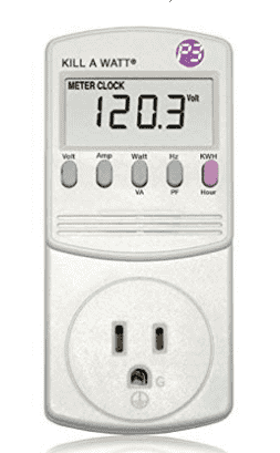

That'd be an interesting experiment for our DIY thread -
one could catch and measure a couple days worth of condensate
and one of these $20 gizmos would tabulate the kwh used (i see they have got even cheaper since i last looked)
i found one laying in the mud at my junkyard. It looked so rough they just gave it to me.
I washed it out and now don't know how i ever got along without one.
To borrow a phrase from Red Green - it's "The Hobbyist's Secret Weapon "
