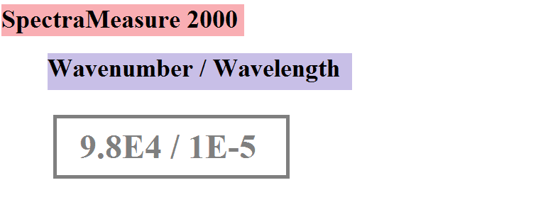

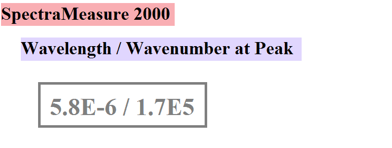

Imagine I have a body at 500 K. I have an instrument that can measure either the energy of a particular wavelength of light or the energy of the wavenumber by a simple switch. I point the instrument at the body when set in wavelength mode, and scan across all wavelengths until I see where the maximum energy value is located. It turns out that the maximum is at a wavelength of 5.8E-6 meters. This is wave has a wavenumber of 1/5.8E-6 = 1.7E5 m^-1. This is definitionally true. So, to recap... the maximum energy is at a certain wavelength, and that same physical wave can be described in terms of wavelength or wavenumber. The physical wave does not change whether it is described by wavelength or wavenumber. This physical result agrees with the predicted value given by Planck's law in wavelength form.
The problem comes when I switch the machine to wavenumber mode. Since the machine is still pointed at the body, and nothing has changed at all, it should now read 1.7E5 m^-1 as the wavenumber with the maximum energy. The physical setup is identical, it is only the mode that has changed. We know for certain that any wave with wavelength X has wavenumber 1/X. That is a fact. Yet Planck's law in wavenumber form predicts we will measure 9.8E4 m^-1. This is nowhere near the value that corresponds to the maximum measured wavelength!
So I hope it is clear that my question is not about intervals or how the differential areas under the curves are different sizes. I am speaking of a single value on the curve - a single, specific wavelength/wavenumber and not an interval. How come Planck's law in wavenumber form predicts a different value from that already measured? To make it clearer, imagine that the machine has a display. When it wavelength mode, it displays the measured value of the wavelength and its corresponding wavenumber. Like this:
And when in wavenumber mode, the display looks like this (according to Planck's law but not according to a simple conversion):
The problem seems to be that if the peak is at wavelength X, and a wave of wavelength X has a wavenumber of 1/X by definition, then Planck's law predicts the same exact physical thing has a different value depending on if it is measured one way or the other. But that cannot be right. The same exact wave has a fixed wavenumber no matter what Planck's law says! The readout from the machine should simply have the numbers reversed.
If anyone can explain this, I would be most grateful. I would like an answer to be very logical, like a logical argument. It should start with some premises and end with a logically-derived conclusion: Therefore, the measured value will change from 1/X when we switch the machine to wavenumber mode.
Thank you!

What does the global maximum of each curve mean, physically? If you can't answer that, you have no basis for any conclusion about how you should expect the global maximum values of the two curves to be related.
Others have been talking about intervals because that is how we understand, physically, what the two curves mean.
davidwinth said:
The same physical thing, a wave in this case, must have the same value for its characteristic description.
What does "the same value" mean, physically? How does that translate into the values for the two curves? Again, if you can't answer that, you have no basis for any conclusion about how you should expect the two curves to be related.
Note that neither of these curves is a curve of "the amplitude of the wave", which is what a "characteristic description" of a wave is normally taken to be. So your logic falls apart right from the start, since it assumes that the amplitude of the wave is what the curves are describing.

It's simply that many people forget that a distribution transforms under change of the variable as a distribution, which is why it is called a distribution. Thinking in terms of "photon number" (though it's a delicate subject concerning Lorentz-invariance properties, but that's not the point here) it's clear that
$$\mathrm{d}N = \mathrm{d} \omega f(\omega) = \mathrm{d} \lambda \tilde{f}(\lambda).$$
Now you need the relation between ##\omega## and ##\lambda##, which is
$$\omega = c k =\frac{2 \pi c}{\lambda}$$
and thus
$$\mathrm{d} \omega = \left |\frac{\mathrm{d} \omega}{\mathrm{d} \lambda} \right| \mathrm{d} \lambda =\frac{2 \pi c}{\lambda^2} \mathrm{d} \lambda.$$
So you get
$$\tilde{f}(\lambda) =\frac{\mathrm{d} N}{\mathrm{d} \lambda} = f(\omega) \frac{2 \pi c}{\lambda^2} \mathrm{d} \lambda = f \left (\frac{2 \pi c}{\lambda} \right) \frac{2 \pi c}{\lambda^2}$$
