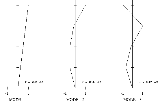

The tower is modeled as a simple cantilever beam, using the first normal mode of T=10 s in order to obtain the physical properties. No floors or columns are modeled, just the beam with a fictional material that makes the tower has the desired mass and first normal mode. It's a very interesting exercise, as it approaches the real event behaviour with very good accuracy. The model oscilates for 4 minutes, just as the real towers did. The exercise tries to prove that they absorbed the impact of the planes no problem. Project wind made the towers swing more or less the same that the planes did, as far as I know. Fire was the real problem there.

First and second natural frequency of the model is 0.1 Hz (T=10s). It's one of the imposed data of the exercise (see my previous post). Third mode is 0.571 Hz.
So the structure takes 5 sec for half a cycle of vibration of mode 1 and 0.87 sec for mode 3, compared with about 0.36 sec of impact time (calculated from average speed / distance).
I would expect the differences in the max amplitude to be mainly caused by amplitude and phase difference in the response of mode 3 relative to mode 1. The impact is probably short enough for the mode I response to be dominated by the total impulse rather than the time-variation of the force, but the force is applied over about 40% of the half-cycle of mode 3 so the response in mode 3 will be more sensitive to the time-variation.
You haven't said what is the main objective of your project, but decomposing the response of your model into modal components would be an interesting way to get more insight into what it is telling you (unless all this is just a detail in terms of your main objective, of course).

About decomposing the response of the model into modal components, I'm forcing the model to only include the first mode. There's an option for that in the damping section you can define.
Using a w_min=0.05 Hz and w_max=0.2 Hz (min and max freq of the structure) gives the results I've been posting.
Testing with a w_min=0.05 Hz and w_max=0.6 Hz gives a maximum deflection of 0.8 m instead of 0.7 m and the damping is less apparent as in the first case where it goes from 0.7 m to 0.5 m to 0.3 m to 0.2 m and including the third mode goes from 0.8 m to 0.7 m to almost 0.6 m to 0.5 m.
Is it more accurate to include the third mode too?.

That depends very much on whether the third mode is an accurate model of the structure.
If you think about superimposing two sine-wave responses at different frequencies and amplitudes, the resultant peak amplitude is sensitive to when the two peaks occur (i.e. the frequency ratio of the modes) as well as their relative amplitudes.
I'm not a civil engineer, so I don't know whether or not a uniform cantilever beam is a realistic model of a tower. Tweaking a model to get one frequency correct is easy. Getting several frequencies correct, and the amplitudes of the response in the correct ratio, is a harder problem.
It would certainly be more accurate to include more modes in an accurate structural model, but the key part of that statement is the worlds in bold.

Those mode shapes make the point rather well. I'm assuming the plane was traveling from left to right. If the impact was at 75% height you would hardly excite mode 2 at all, because the impact is near a nodal point. On the other hand it the impact was at 50% you would excite mode 2 with the initial motion in the opposite direction to the diagram, and you might find the top of the tower started moving in the opposite direction to impact before it swung in the same direction, because mode 2 is a higher frequency than mode 1.
Mode 3 would be a similar story to mode 2, except 50% is now near the nodal position.
