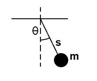

Consider a plane pendulum of mass m and string length s. After the pendulum is set into motion, the length of the string is shortened at a constant rate. The suspension point remains fixed. Compute the Lagrangian and Hamiltonian functions. Is energy conserved?

I need some help with this problem. I've solved most of it, but I need some help with the Hamiltonian. I will run through the problem as I've solved it, but it's the Hamiltonian at the end that gives me trouble.
To find the Lagrangian, start by finding the x- and y-positions of the mass and their velocities (keeping in mind that s is not constant):

from the Hamiltonian, I get the correct answer. But why? The system needs both the coordinates theta and s to define it. Looking further at energy conservation of the system I see that in my (incorrect) solution, the Hamiltonian is expressable by T+U, and therefore energy would be conserved. But I can reason that this shouldn't be the case: Consider a small (negligible) initial angle theta and large initial string length s. Then, as time progresses, T won't change by much, but U will. Thus energy is not conserved (the answer sheet gives the reason that work is performed on the system). Why shouldn't the term above be included in the Hamiltonian?

I don't think ##s## is a degree of freedom. You don't have to determine its motion since it's already given to you. It says shortened at a constant rate so it's something like ##s \sim \alpha t##. And because you don't have to determine its motion it should not be an independent variable in your Lagrangian or Hamiltonian. This is why you emit the ##\frac{\partial L}{\partial \dot{s}} \dot{s}## term.That's my take on it.
You just have to be mindful at the end of everything ## s = - \alpha t## and it's not constant (however ##\dot{s}## is).
Likes hicetnunc
Actually it should be included in your Lagrangian as ##s = - \alpha t##.
But you don't have to take derivatives with respect to it since it's already constrained as given to you.

Ok, so using ##s = -\alpha t## to rewrite the Lagrangian as ##L = \frac{1}{2} m(\alpha^2 + \alpha^2 t^2 \dot{\theta}^2)## makes ##s## disappear from the equation and makes it only dependent on time and ##\dot{\theta}##. And then ##\theta## becomes the only coordinate to use in the equation for the Hamiltonian.

Alright, here goes. To recap: ##s = -\alpha t##, giving ##L = \frac{1}{2} m (\alpha^2 + \alpha^2 t^2 \dot{\theta}^2) - m g \alpha t \cos{\theta}##. Then the Hamiltonian becomes:

and total energy is not conserved, as should be.
