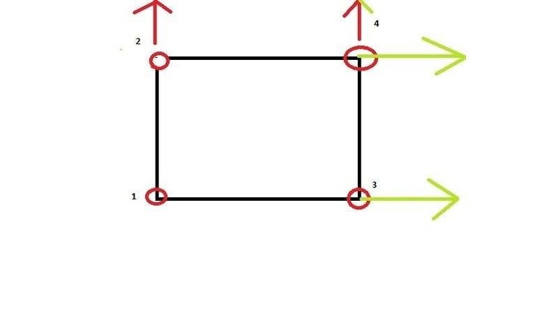

Dear All,
I just have a single element, I need to apply a plane stress condition as in the attached image.
For the boundary conditions;
• I have constrained the nodes 1 and 2 in the horizontal (x) direction
• I have constrained the nodes 1 and 3 in the vertical (Y) direction
• I have constrained nodes 1,2,3 in z (perpendicular) direction.
• I have got a constant stress and strain throughout the element
Are the results i.e. stress distribution correct qualitatively? Have I applied the boundary conditions correctly?
Please can anyone advise?

Please can anyone help? I shall be rally grateful//
