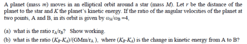

Please see below
Not sure
(a) I use centripetal force to solve this question, even though the question states elliptical orbit
$$\frac{GMm}{r^2}=m\omega^2 r$$
$$\omega^2 r^3=GM$$
So,
$$\omega_{A}^{2} r_{A}^{3}=\omega_{B}^{2} r_{B}^{3}$$
$$\frac{r_A}{r_B}=\left(\frac{\omega_{B}}{\omega_{A}}\right)^{\frac{2}{3}}$$
Is this correct?
Thanks
I don't think you can use that formula in an elliptical orbit. There can be a radial component to the acceleration.
What do you know is conserved?

Just let me emphasise that you most definitely cannot use that formula. It assumes that the radius is constant, which directly contradicts the assumptions of the problem.
As an additional hint, all you need to know here is that the potential is central. The actual functional behaviour of the force magnitude is irrelevant.

I think it should be angular momentum, so:
$$m v_A r_A = m v_B r_B$$
I don't think I can use ##v=\omega r## because it is not circular motion so how to relate the equation to ##\omega##?

Not exactly. The angular momentum depends only on the tangential component of the velocity.
As such, ##\omega r## is definitely equal to the tangential component of the velocity by definition.

An apparent paradox is that, if one assumes that the planet moves in a straight line at constant velocity, one gets the correct answer for part (a).

Seeing the question, the first part can be done using Kepler law which you have done correctly. For second part basic conservation of energy can be utilised to solve it.

If you mean Kepler III, the radius in that law refers to the semi-major axis. It is a law relating all planets orbiting the same star, not all positions of a given planet. It does not apply to the first part of this question.

Maybe you mean something like this?
$$mv_Ar_A\sin \theta=mv_Br_B\sin \beta$$
where ##\theta## and ##\beta## is the angle between ##v## and ##r## at point A and B. Using ##v=\omega r##:
$$\omega_A r_{A}^{2}\sin \theta=\omega_B r_{B}^{2}\sin \beta$$
The question does not give information about ##\theta## and ##\beta##. How to continue?

No, ##v_B\sin(\beta)=\omega r_B##, etc.
songoku said:
Is ## \ddot r## the angular acceleration?
No, it is the rate of increase of the rate of increase of the radius. In a circular orbit it is zero.
The component of the acceleration vector in the radial direction is ##\ddot r-r\omega^2##. See e.g. https://proofwiki.org/wiki/Acceleration_Vector_in_Polar_Coordinates
Note also that the centripetal acceleration is not ##\omega^2r##. Centripetal acceleration is that component of the total acceleration which is normal to the velocity. If the velocity has a radial component then the centripetal acceleration is not entirely radial. The full expression for it in polar coordinates is horrendous.

For angular momentum use ##~~\mathbf L =\mathbf r\times\mathbf p##.
Remember that ##~~\mathbf p=m\mathbf v## and ##\mathbf v=\mathbf \omega \times \mathbf r##. Put it together using the vector triple product rule.

This is incorrect.
Please refrain from confusing the OP by providing wrong answers.
I understand.
Thank you very much for all the help and explanation haruspex, Orodruin, kuruman, Super Man
