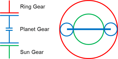

I'm looking to calculate the ratio of a planetary gear train. With the ultimate goal of producing a spreadsheet/calculator to show the state of the gearbox (i.e. all shaft speeds) based on applied constraints.
A gear set consists of Ring Gear, Planet Gear, Sun Gear. The sick diagram is the easiest way to show the interactions and constraints. The rotational speed of any part can be found by:
(R+S)*ωp=R*ωr + S*ωs

Single Planet Case
This is the type of thing you'll find with a generic google. Output speed can be directly calculated based on the constraints. In this case we have three states, two constraints and one gear equation to find the output. Easy peasy.
