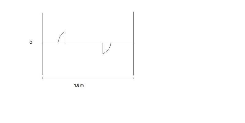

A thin plano-convex lens of focal length f is split into two equal halves. One of the halves is shifted along the optical axis as shown. The separation etween the object and the image planes is 1.8m and the magnification of the image formed by one of the half lens is 2. The separation between the two halves is d. Find out f and d.
Let the distance between the first half and the object be x.
This half will form an image at a distance given by (by using lens equation)
v= fx/f+x
This will act as an object for the second lens with distance v+d and the image is formed at a distance v1 = f(v+d)/f+v+d
we have x+d+v1 = 1.8
3 equations and 5 variables.
I am stuck.

Geometry Optics! Eek, you ask about the field that I suck at :biggrin:
The question is not clear enough; I guess all the final images are at the same position, at a distance 1.8m from the object. There are 2 cases:
1/ Light from object --> first half --> straight to the image plane.
2/ Light from object --> first half --> second half --> image plane.
So that is one image. There is another image: light from object --> second half --> image plane.
From here, you can eliminate one case by noticing a hidden symmetry :wink: Hint: The two halves have the same focal length and there is symmetry between x and x' in the lens equation 1/x + 1/x' = 1/f. Also notice that the final images are at the same position.
Look for that symmetry and you will solve this problem in seconds :biggrin:

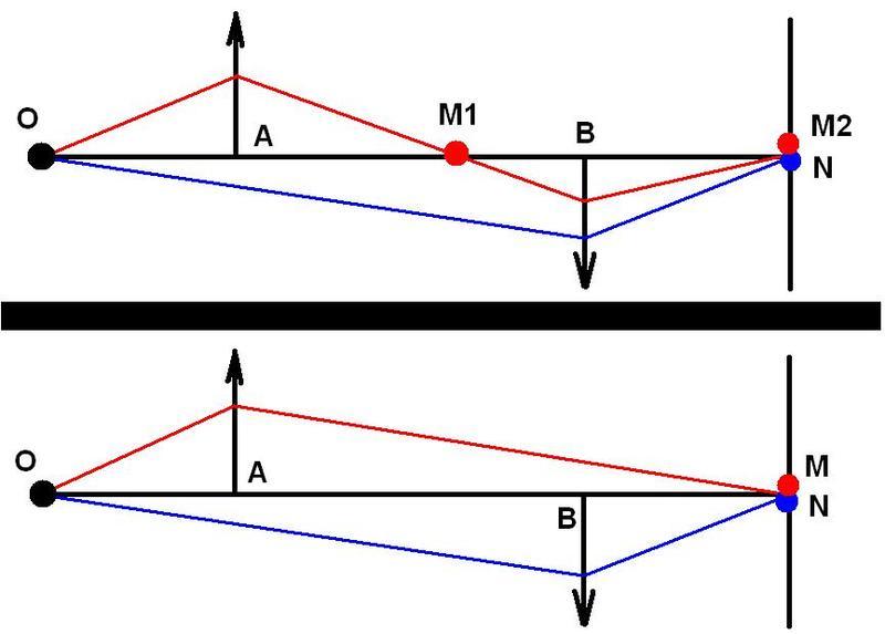

Now some picture :biggrin: The first one is my second case, the second picture is my first case. See something weird with M1 (the image of the object O through the first half)?
For the same object distance, the path of the ray from first half has to be either of those given in your figure.
I think that if the source and screen are interchanged, the path of the light from N (which will now become the source) should be the same as earlier with direction reversed but there will be one more possibility for the path of the light (directly through first half). In other words there is not only a change in the direction of the rays but also in the position of the rays. But this will violate laws of symmetry. So the first case if not possible.
Am I correct in my reasoning?
Yep :approve:
Now that you eliminate the first picture. Proceed with the second one. See some symmetry?
I solved it and got f=0.4m and d=0.6m. Thank you very much for your help.
