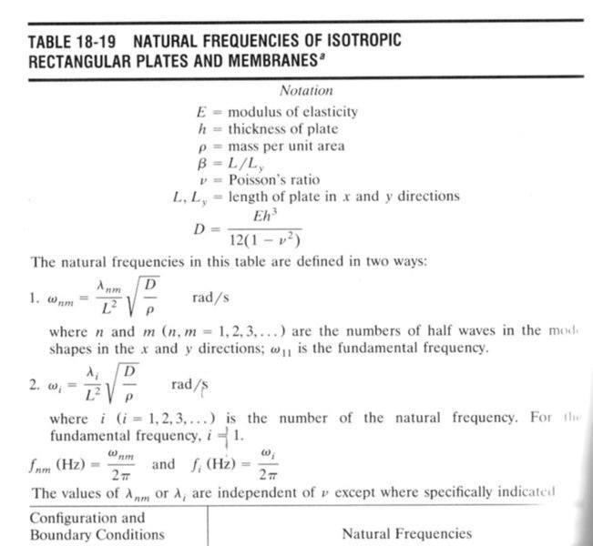

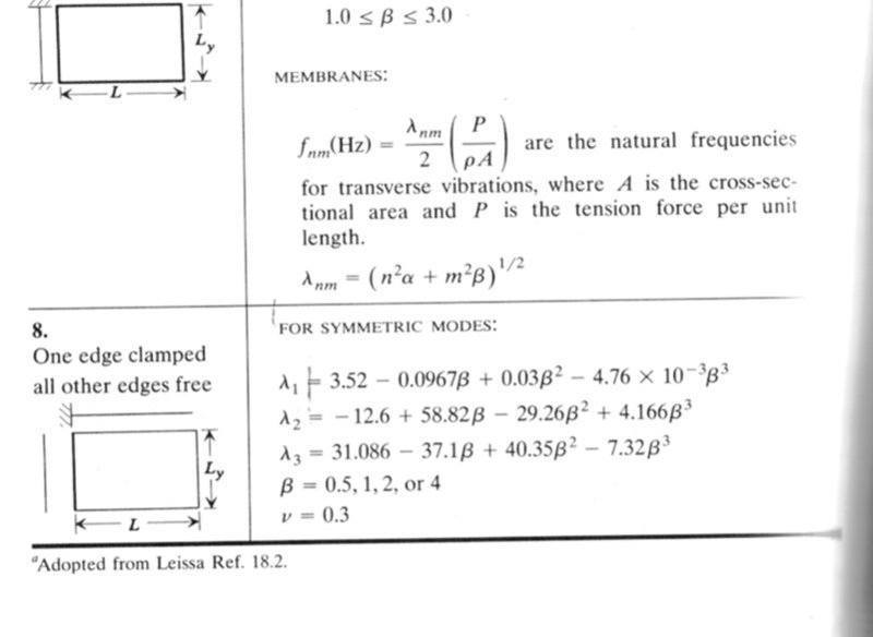

I am still not sure about the 'beating' question. I am guessing that you are thinking of resonance with all the organisms beating in synchronicity a la soldiers marching over a bridge and their step inducing vibrations in the structure?
If this is the case there are published tabulated solutions.
The attachments ( an extract from Pilkey) shows solutions for your particular case and the notations for the tables.
