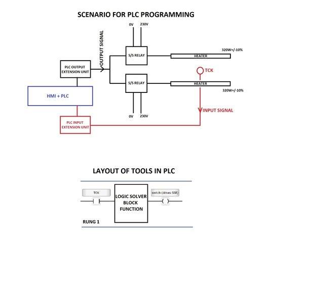

In summary: The draft "PLC4" attached shows the schematic diagram of the PLC. The TCK is fixed to the machine and is not in a physical contact with the heaters. Nominal temperature of machine is 200degC. The machine temperature tolerance is +/-2degC. This means that the heaters should be turned on when machine T drops to 198degC and turned off when T reaches 202degC.The draft "PLC4" attached shows that the SSRs are used as inputs and the Heaters are used as outputs. Was this intended?

Hi,
I would like to provide the PLC control for a scenario where the temperature in a machine, heated by the two electric heaters, is controlled with use of 1 TCK and 2 s/s relays. Please see draft “PLC4” sent attach. The TCK is fixed to the machine and is not in a physical contact with the heaters. Nominal temperature of machine is 200degC. The machine temperature tolerance is +/-2degC. This means that the heaters should be turned on when machine T drops to 198degC and turned off when T reaches 202degC.
For this moment I have created the start PLC diagram outlined on draft “PLC4”.
I am still learning PLC. Therefore, I would be very grateful for your opinion whether the PLC diagram shown on picture “PLC5”, in terms of the tools used (direct contact, direct coil, etc.) and their layout, is of proper design.
I know that there is much more work needed to complete this task (e.g. set up of the variables, etc.).
Please help.
Thank you.

Referring to your image PLC4.jpg, the block diagram of the system shows the PLC driving the SSrs which drive the Heaters, as expected.
But the Ladder Logic portion shows the SSRs as inputs and the Heaters as outputs. Was this intended?
--| |-- is a normally open input contact, --( )-- is an output
I hope you realize that ±2°C at 200°C may require some thermal insulation, especially if this is the desired outer surface temperature.

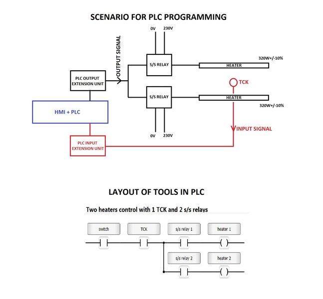

Thank you for your reply.
The SSR should be the output here. Thank you for pointing at this.
I have corrected the PLC tools layout concept and I send it attached.
Indeed, ±2°C at 200°C is quite tight considering that the heated machine component has bad thermal insulation. This temperature range is the desired target however, it may be that without thermal insulation the range will be broader.

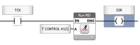

I think I have might found the PID block in UniLogic. I send attached the new ladder.
The thermal mass of the whole component will hopefully be large enough allowing for uniform heat distribution, what can be advantegous in regards to maintaining tight temperature variation across the component width and heaters not 'fighting' with each other.

Great, it has PIDs. Hopefully a sufficient number of them and with auto-tuning capability.
And I see you are doing a retrofit rather than an original build. In other words, if you have a constraint you can't negotiate it away!
