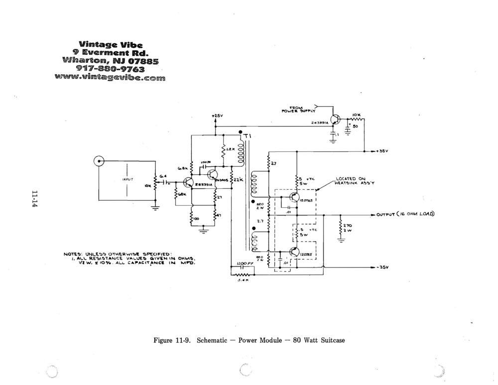

Since this is a classic instrument, I found plenty of info, so the rebuild went well, but I'm curious about one thing, and want to check my calcs/assumptions on another. The amps were upgraded from their old/obsolete (and blown!) germanium T03 power transistors, to silicon MJ15025. These were originally biased with an 820/2.7 Ohm divider, with 36V~38V supply at top of the 820, and the 2.7 across B-E (emitter near ground when idle). With roughly 36 V across the 820 Ohm, that's ~ 1.6 Watts. Those old 820 Ohms were burnt and did some charring of the fiberglass PCB, they looked to be 2W or 3W carbon comp parts ( ~ 3/4" L x ~ 5/16" D), not sure of the size for watt ratings for 1970 era resistors? Does not seem like much safety factor to me, and probably is the reason for the failure. For the silicon transistors, the sources say to use a 3W rated replacement for the 820. I did that, all tested out good, but that 820 Ohm was hot, around ~ 140F~145F estimated, I could touch it for ~ 4 seconds. The part is rated for a surprising (to me!) 235°C . Holy Cow, it can withstand 135 C over boiling, that's 455 F! No wonder they talk about flame-proof coatings. I was just not familiar with these sorts of specs. But I was also just not comfortable with such a hot running part.

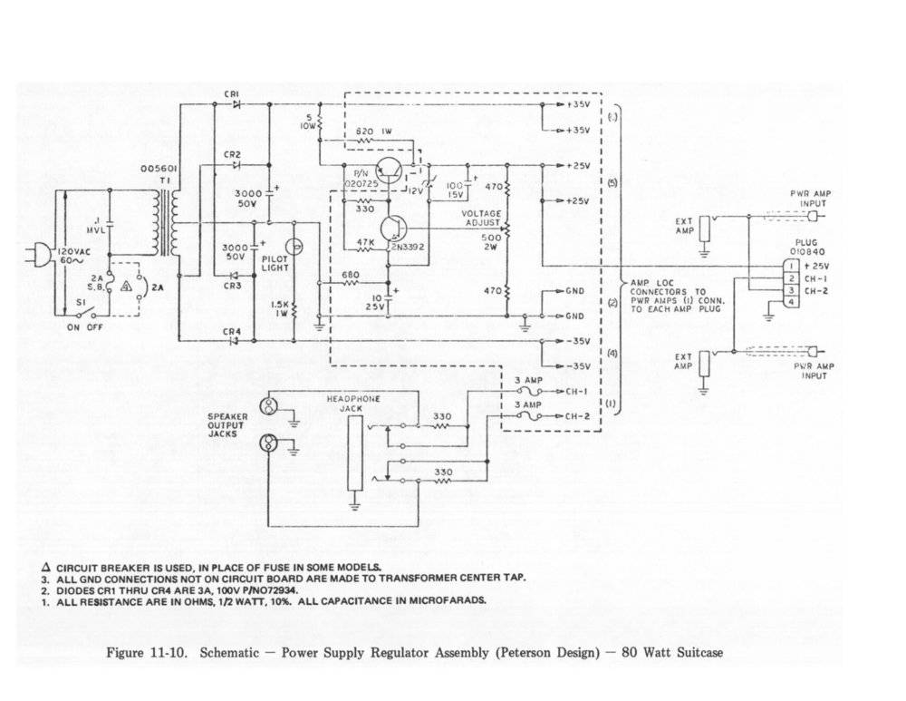

Second question on Transistor dissipation: I also had to replace a transistor in the voltage regulator, which needs to handle ~ 2W (10V x 0.2A), and since I had spares of the high powered amplifier output transistors (250 W @ 25C case), I just used one of those, without any heat sink. Thermal Resistance, Junction−to−Case, is listed as 0.70 C/W. The case gets warm, but not hot - not above 140 F (60 C). So is my calculation correct - the junction temperature would be just 1.4 C above the case temperature? Spec is Operating and Storage Junction Temperature Range, −65 to +200_C. So I'm well within limits?

Thanks for the confirmation. My designs in my career rarely involved higher power levels, and were all for in-house use, usually just one-ups, or a few dozen at most. So it was reasonable to just go way overboard on safety factors rather than spend much time trying to calculate more exact figures, so I'm really rusty on these calculations, but the numbers seemed to be making sense to me. It was a good review for me - the basics!
Yes, the 820/2.7 Ohm was for the original Germanium transistors (quasi-complimentary A/B output drive circuit). On the forums, they were recommending ~ 12 ~ 15 ~ 18 Ohm range for the Silicon replacements, increasing values to reduce crossover distortion if needed, while monitoring the heat sink to keep idle power low enough to not get "too hot" (but no one published current measurements). Some even talked about also reducing the 820 Ohm to 680 Ohm to reduce crossover distortion, but that is going to increase the dissipation on that R even further. I was able to increase the 820 to 1020 Ohms (510 + 510), and used an 18 Ohm for the B-E resistor, so that drives the base with a reasonable ~0.64 V on a 37 V source. I measured ~ 100 mA idle current, so at idle ~ 3.7 W per transistor. No visible or 'hear-able' crossover distortion, so I left the bias there. The heat sink (~ 5" x 5" with ~ 1" fins) was barely warm, and after a couple hours of music playing through it, my IR gun read 100~105F, even though it was laying down, minimizing air flow. The amps mount inside the big speaker cabinet, so lots of air available.

  • page 80 - 80Watt Power Amp Suitcase .pdf
  • Rhodes a - Power Supply & PreAmp_.pdf
Try importing as images rather than attachments:
243092
