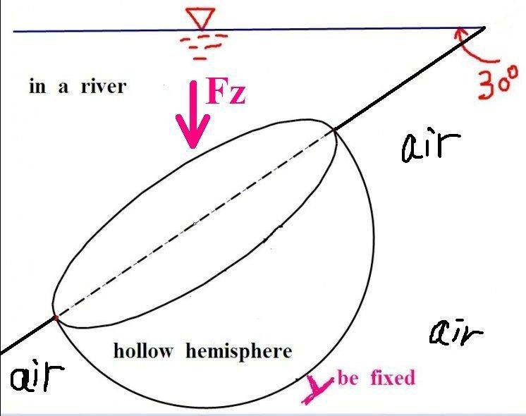

Please find the force Fz which the hemisphere endures

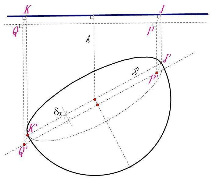

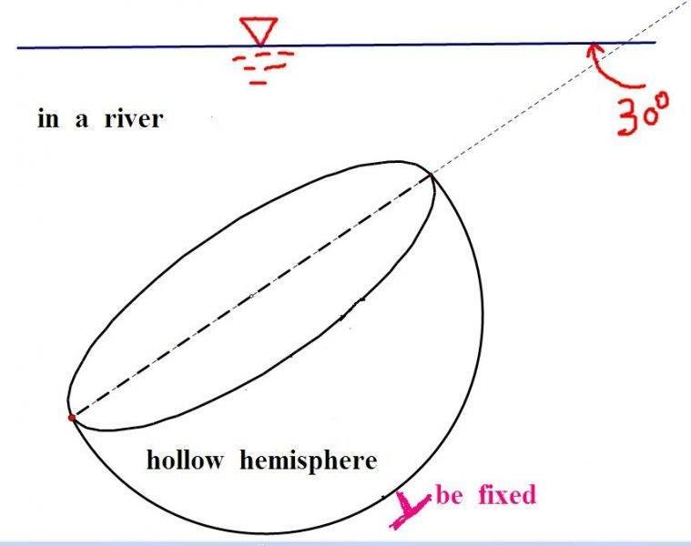

My way: "on" the hemisphere, I want to use triple integral(but I'm not sure the way's right) and cut into the part into many innumerable tiny 3D right angled trapezoid
(i.g. KJPQ-K'J'P'Q')
Then I think that:
ρgV( the part + the hemisphere)=Fz
Because my math is weak, I hope somebody can help me.
If you can understand the problem, please tell me whther my way or my calculation is right or not, thank you!

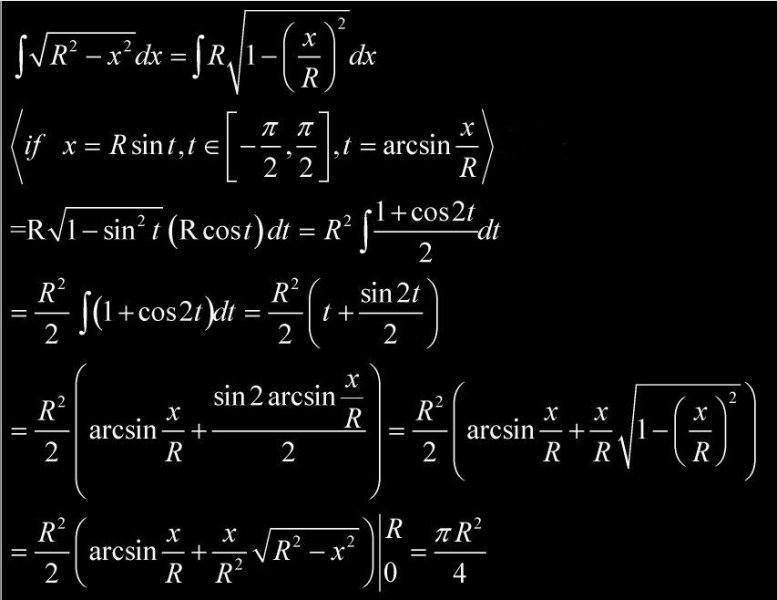

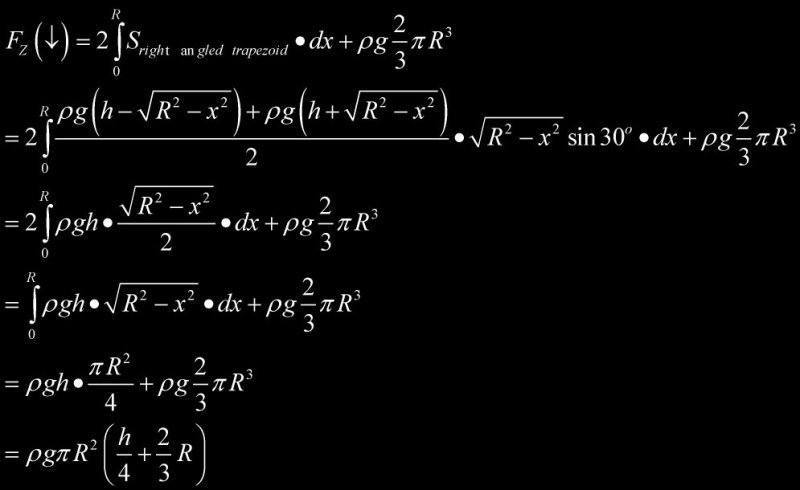

The following is my calculation.
ps: one integral

And you can imagine that one hollow hemisphere is located under one still river by 1 person.
Of course the hemisphere is fixed obliquely as in the fig( dip angle=30°).

This is a hollow sealed hemisphere being held immersed in a liquid. It is held at an angle. You want the force required to hold it down?

The hemisphere is not sealed, :smile:in other words, the hemisphere isn't closed.And I want to know the force which the river water exerts to the hemisphere.
Additionaly I don't know whether my method is right or not.
(PP'Q'Q is an right angled trapezoid just the same as JJ'K'K)
Are you familiar with Archimedes principle? Does the vertical force exerted by the surrounding fluid on a submerged object depend on its depth or orientation?

If it's hollow and not closed, do we know the shell's thickness? If it has no thickness it displaces no volume, so there is no buoyancy.
Or... is this a question about hydrodynamics... force due to fluid flow over a surface?

_________NO, not hydrodynamics but hydraulics... force due to the still river water over the hemisphere shell

IT'S true that we are unnecessary to know the shell's thickness.ρgV( the part + the hemisphere)=Fz
the part=the water on the hemisphere(at the moment, you can imagine that the hemisphere is sealed or closed.)
the hemisphere= the water in the hemisphere(at the moment, you can imagine that the hemisphere is sealed or closed.)

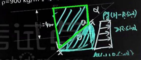

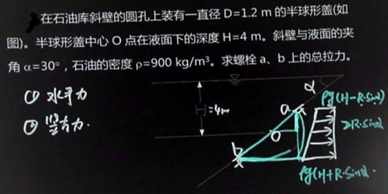

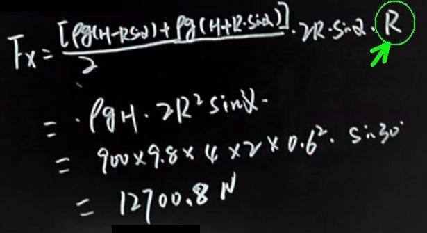

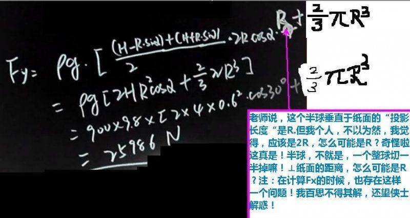

Equipped with a D=1.2m diameter hemispherical cap in the circular oil depots inclined wall, hemispherical cap center point O, depth of H=4m in the page. Inclined wall and thelevel angle of α=30 degrees, there is the density of ρ=900kg/m^3. and total tensionbolts a, b.
All above calculations are made my teacher!
But I cannot agree with him( I feel very puzzled with R circled by me)
Maybe the above fig is more helpful to calculate Fz

Indeed it is, particularly the label "air".
Your challenge to the 'R' is in regard to Fx, not Fz. The part in square brackets (divided by 2) is the pressure at O, and by symmetry it is the mean pressure acting over the circular opening to the hemisphere. To get Fx, you want to find the effective area in a vertical plane. That will be sin(alpha) multiplied by the complete area. But what I see as wrong is that the complete area is written as 2R2 instead of ##\pi R^2##.
Your Fz corresponds to Fy in the later calculation. This calculation is the same, except that it's cos instead of sin, and you have to add the weight of the water in the hemisphere.
