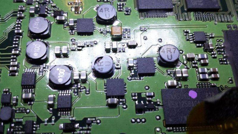

I have a Casio FH-20 camera. I tried looking for a schematic to no avail. Everything in the camera works fine except that it will no longer remember the date/time when the batteries are removed. I figured there was a lithium battery in the camera that went dead (it's about 8 years old, I believe), so I took it apart.
On the main board is a broken component (literally broken).. I *think* it's a capacitor, which would make sense as far as backup of the date/time would go.
Here's an image of the main board with the broken component. The # on the piece is 4R7U. But haven't found anything online which necessarily would be a replacement.
Thanks for any help!

just a guess here
it's a 4.7 uh inductor not unlike this Panasonic
http://media.digikey.com/pdf/Data Sheets/Panasonic Electronic Components/R_Series_ELL5PR.pdf
reason for that guess is it looks like a coil under the hole in its top
and the large solder pads suggest a power handling component
not to discourage enthusiasm, but if it blew its top there is probably something else wrong that caused it to do that
can you measure the DC and AC voltages across it in operation ? Compare to others? Unsolder and compare its resistance to one of the others? That takes surgeon's fingers.

agree with Jim ... definitely an inductor
I don't see any backup capacitor or battery in that circuit ... show a fuller pic of the circuit board pleaseDave

It also looks like some components were burned off of the board at the top of the picture.
BoB
My vote is for a 4.7 uH inductor as well
However, the ferrite might be a bit broken but the main magnetic loop of the inductor seems fine. The inductor should still work ! Maybe the inductance would drop a bit but most circuits can take some variations of component values without any problem. Maybe the burned-off component at the top?

I had earlier asked for a fuller board image, but, as is common, the OP has been silent, so we may never know the whole storyDave
Sorry Dave, was busy over the weekend. This is about 90% of the board. Also, I never got an email notifying me of the other replies, so I didn't bother to check.
