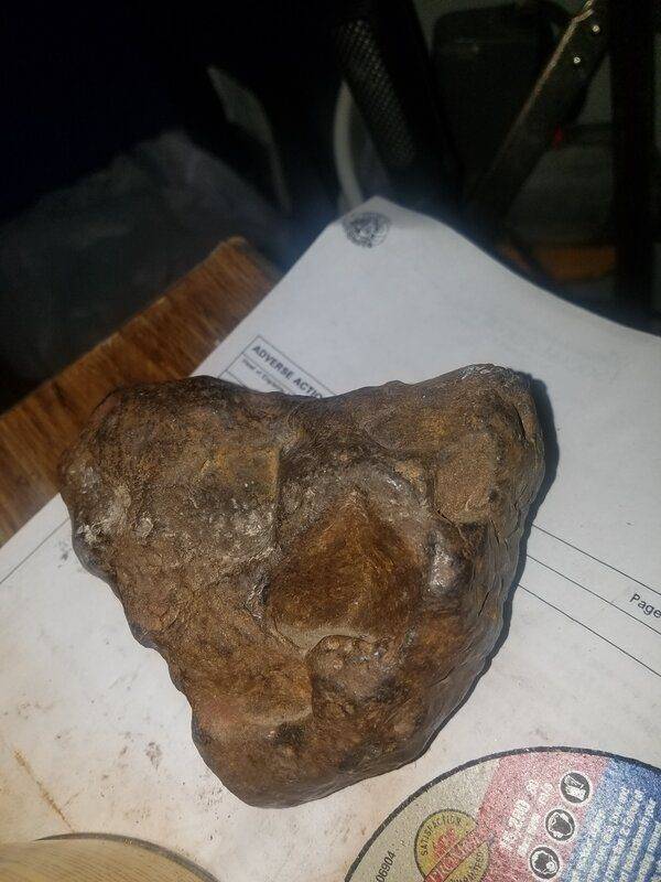

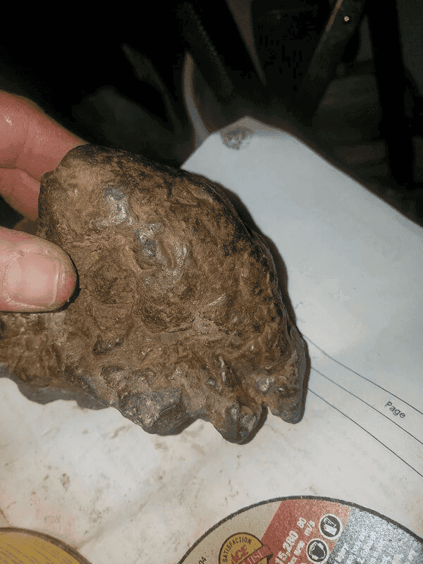

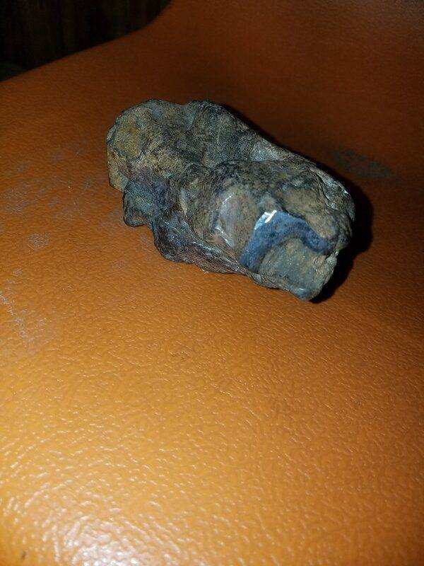

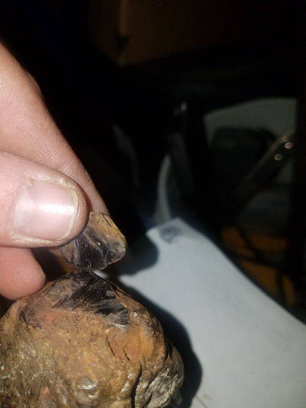

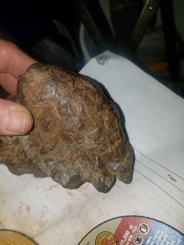

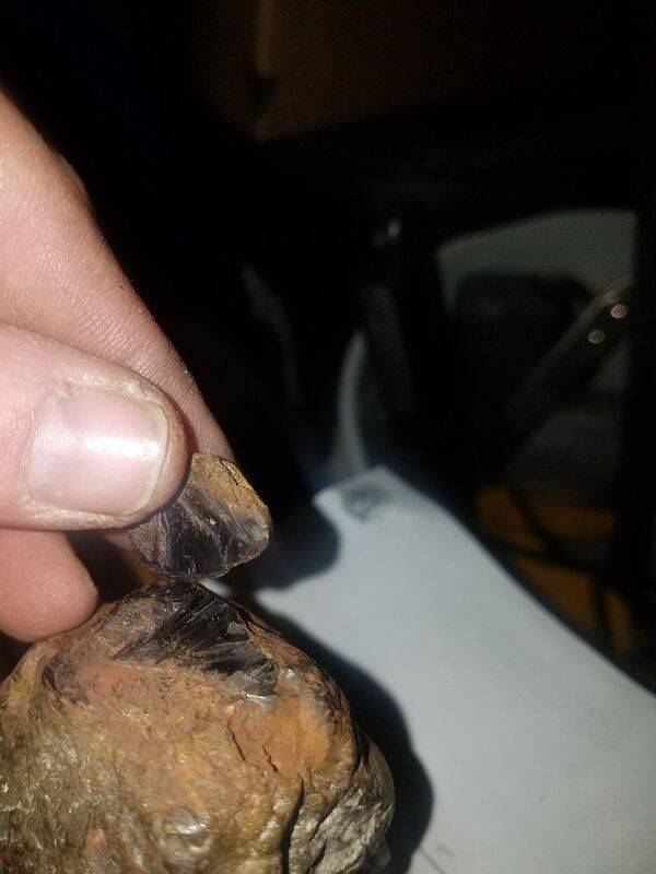

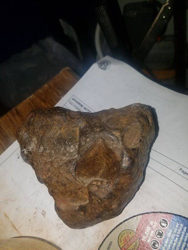

I recently found this rock...it is very heavy, leaves a distinct brown mark on unfinished white tile, and was quite difficult to cut a piece off from a corner. Could it be a meteorite? Please reach me at [personal e-mail deleted by a Mentor]
Hi there Keith,
welcome to PF
collecting meteorites is a pretty serious hobby of mine
Initial thoughts is that it looks like a lump if iron slag from a furnace.
the photos are a bit dark, so hard to make a good visual analysis
Please redo the 3rd and 4th photos again, outside in natural light and with the 4th photo get in a bit closer :smile:
But as @berkeman says, please tell us where you found it and I can have a look and see if there were any known
iron met's in that area
cheers
Dave
Likes russ_watters, berkeman and Vanadium 50
Sounds more like a piece of slag. Does it have vesicles? (Little holes, like it underwent extreme heat)

millzee said:
I found it in southwest missouri...would iron slag hold a magnet?
usually but not always, does your sample stick to a magnet ?
Again, please redo the photos I asked for and answer @Vanadium 50 's question on vesicles

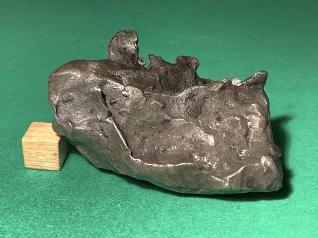

The thing that really puts me off thinking that you have an iron meteorite is that it totally lacks
scalloped areas, rather your one has lumps...

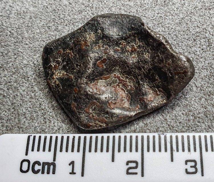

here's a couple of my iron meteorites
They show features that can only happen with a hot flight through the atmosphere...
Dave
Likes hutchphd, anorlunda, berkeman and 1 other person

davenn said:
it totally lacks scalloped areas, rather your one has lumps
I'm having a hard time telling lumps from dents. Much less regna...regma...regmalith...regmagl...oh, to heck with it!
  • Haha
Likes davenn

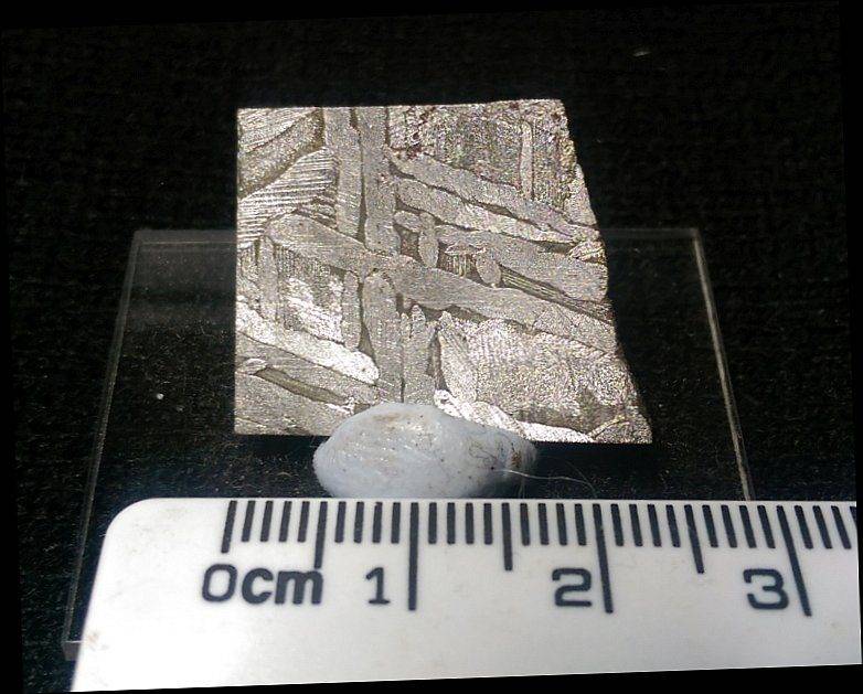

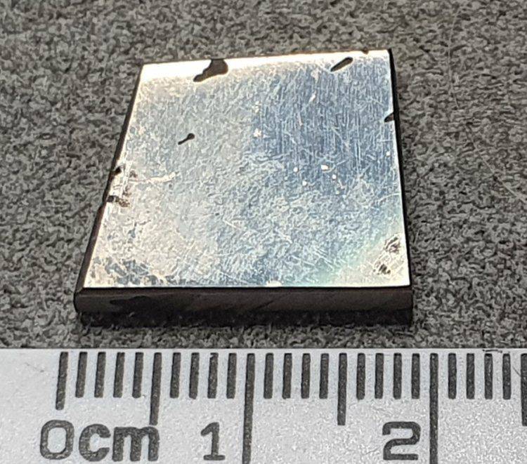

Could you section it, polish and acid etch it? Widmanstatten pattern? Or EDX it and report the Ni content?
Likes davenn
This of course is the best test for any possible iron meteorite
Something like 98-99% will show a Widmanstatten pattern after a surface is cut, polished and etched
The other 1% are Ataxite irons which have a very smooth interior after being polished and will
show occasional sulphide inclusions
Likes chemisttree and BillTre
