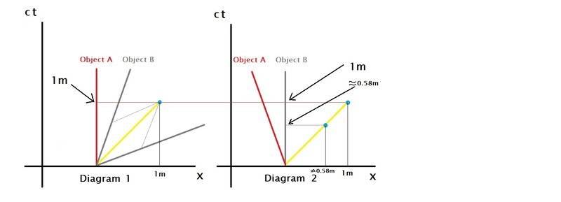

Here is a simple scenario where Object A and Object B cross past each other on an x-axis (for simplicity sake, let's just assume that they somehow passed each other on one spatial dimension). As they cross past each other, a photon gets released in the positive direction, and then gets absorbed soon after at the event (in blue). Below is my attempt at making two spacetime diagrams for this situation.
In Diagram 1, we see that I tried to show approximately where the event is relative to Object A and Object B. If my diagrams are at all correct, then the event is closer to Object B in space and time.
My problem: In Diagram 2, when Object B is at rest, the event shows up much further in spacetime than what I had shown in Diagram 1. Why does everything stop making sense when I try to make a diagram for the rest frame of Object B?
If you've drawn your diagrams accurately then you will find that the ##(t,x)## coordinates of any event in one frame and its ##(t',x')## coordinates in the other satisfy ##c^2t^2-x^2=c^2t'^2-x'^2##. I don't think you have drawn the diagrams accurately, however, since the meeting event of A and B lies on the x-axis in both diagrams. That can only happen if the event is at the origin.
What calculations did you do to draw these diagrams? Specifically, what are the coordinates of the meeting point of A and B, and the coordinates of the absorption event in each frame?

I did not think it was necessary to use calculations because I just wanted to see if the diagrams made sense in principle. I will attempt using an actual calculation with help from a video from Khan Academy to make all this more clear.
In his video, he uses distance units for the y axis. So my y-axis will be t = d/c, then d =ct. To make this easier for me, I will use the numbers he uses in his example. So ct = 1 and x = 1 for the meeting event. Using Khan's calculations, this brings the values of the location of the blue event to roughly (0.58, 0.58) like in his example.
The problem seems to persist for me. I think that I am missing a major principle or factor here, but I can not find it.

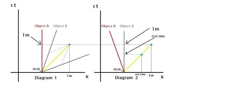

What event is "the meeting event"? If it's the event where Object A and Object B meet, I strongly suggest that you read the first paragraph of @Ibix's post #2 very carefully.
Yes, the meeting event is where they meet. I think a crucial point of @Ibix's post is this, "That can only happen if the event is at the origin.", but I am not sure which event is being referred to or what the origin has to be. The origin that I chose is where the meeting event is. But does the origin have some other implicit meaning in relativity?

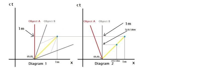

I also need to label the meeting event with the calculations as (0,0).
Here I have put in the origin (0,0) at the meeting event. I did not use the ct axis as the vertical world lines because I wanted the world lines to be visible and clear.
That's a good start. Now go and label all the other events with their correct coordinates in both frames. (Hint: you will not be able to do that correctly with Diagram 2 without redrawing it.)

To be fair, he has done so, although he has still got the axes displaced and hasn't stated that the relative velocity of A and B is 0.5c. (Edit: and the blue event from diagram 1 is duplicated on diagram 2 for some reason - see the next two posts.)
@student34 - the only problem with your diagrams in #9 is that the event you marked as the origin is not at the origin as shown by your axes.

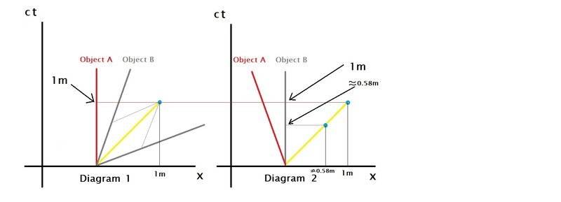

Regarding my OP, do you know why there seems to be 2 different locations of the blue event for Object B? Is the event 1m and 1m away from Object B, or is it 0.58m and 0.58m. I am still confused about this.
Because you drew it twice. Why, only you can answer. I assumed you copied the event location from diagram 1 to compare its location in diagram 1 to its location in diagram 2 - it certainly does not represent any relevant event in diagram 2.
In the rest frame of A, it's at (1,1). In the rest frame of B it's at (0.58,0.58).

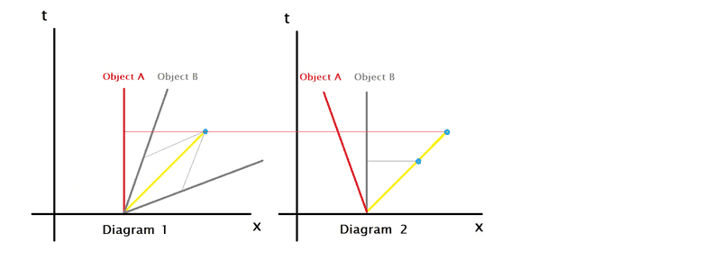

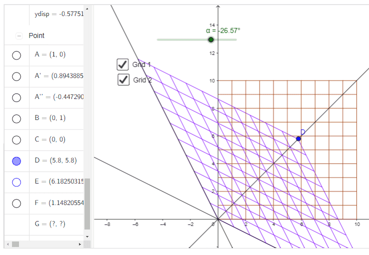

That is wrong. In both diagrams, the red world line of object A is the ct-axis and the gray world line of object B is the ct'-axis, because the objects met at event x=x'=t=t'=0. So A stays at x=0 and B stays at x'=0. You need no extra black axes.
Diagram 1 shows the gray ct'-axis and the gray x'-axis, as labeled in the video. In diagram 2, a red x-axis is missing. The x'-axis is oriented horizontally in diagram 2 and should be gray.
You should also be aware, that in each diagram the axes of the two frames have different scales, because the "rotation" of an axis is not a normal rotation, but a hyperbolic rotation.
Source:
https://www.geogebra.org/m/dYyg5ZB8#material/NnrRvA46
Likes student34 and vanhees71
I did not want to use the y-axis for each object's ct axis because I wanted their respective world lines clear to me. I didn't think it mattered. But you are right, it makes things more confusing in different ways.

I think I know what I did wrong now. I think that I changed the rest frame to B while also keeping the rest frame of A. This is probably why I am getting two events for B. Do you agree?
The "y" axis can anyway not be each object's ct (ct') axis because in each diagram only the ct (ct') axis of the object at rest is vertically. The ct' (ct) axis of the moving object has an angle, for example ##\arctan(-0.5) \approx -26.57°## for v/c=-0.5. So there is no overlapping of axes.
Yes.
