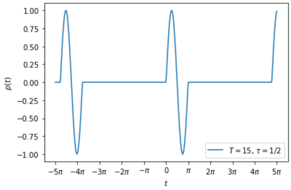

Consider the function ##p(t)=\sin{(t/\tau)}## for ##0\leq t <2\pi \tau## and ##p(t)=0## for ##2\pi \tau \leq t < T##, which is periodically repeated outside the interval ##[0,T)## with period ##T##. Plot this function for ##\tau=T/30## using a restricted set of Fourier coefficients.
The complex Fourier series: ##\sum_{j=-\infty}^{\infty} a_j e^{i2\pi jt/T}##. Since the ##p(t)## is real-valued, we have ##a_{-j}=\overline{a_j}##.
I have plotted the function for ##T=15## and ##\tau=T/30## below with the following code in Python:

Output:
I would now like to plot an approximation to this function using a restricted set of Fourier coefficients. How can I do that in python?
Perform an FFT to identify the amplitude and phase of the harmonics present in the signal.
Likes schniefen
Yes, I was thinking along those lines, that is, to find the coefficients through FFT. I am very new to this, so I have had little experience with FFT.
Take a data record that includes an integer number of full cycles, or exactly one full cycle of the waveform.
Avoid a step where the ends of the waveform wrap around.
An FFT works best on 2^n samples, so generate the function with a sampling rate that results in maybe 64, 256 or 1024 samples.
Calibrate your analyser with some known sine and cosine waves.
Likes schniefen
