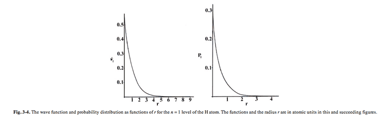

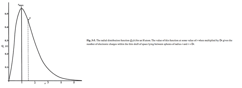

I've been trying to make sense of these curves (attached).
Fig 3-4 is the wave function and probability density. Fig 3-5 is the probability distribution.
I don't understand what units they are using on the y-axis. The probability density must be in P/ao3. I don't understand what they're using in the wave function or distribution curve.

Look at the first plot showing the ground state wave function. The caption says that the function is in atomic units. This means that in the equation [itex]\psi(r)=\frac{1}{\sqrt{\pi} a^{3/2}_{0}}e^{-r/a_0}[/itex] you must set a0=1. Do that and evaluate the function at r = 0. Does what you get match what you see plotted for the value of the wave function? Square that. Do you get the value that the probability plot shows for r = 0?
So, the y-axis of the first curve should really be labelled psi/ao-3/2, and the y-axis of the second curve should really be labelled P/ao-3. Correct?
Either that or say what they say, that the wave function is in atomic units.

But back to my original question. You said:
kuruman said:
dP is dimensionless, but dP/dr is not. Starting from the expression for dP, you multiply by the Bohr radius and divide by dr to get a dimensionless expression.
I see how they got to their solution but I'm a bit confused as to why they multiplied by ao. When I integrate the function that has not been multiplied by ao from zero to infinity I get 1. However, when I integrate the function that has been multiplied by the bohr radius I get the bohr radius. Why don't they just leave it and plot dp/dr?
Because they want to plot a probability distribution and probability distributions are dimensionless. dP/dr has dimensions of L-1; multiplying it by a0 makes it dimensionless.
