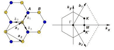

graphene lattice is:
ok. So if you set kx=0, and iterate ky you will plot through all the symmetry points. Also, K=(b1-b2)/3, K'=(2*b2+b1)/3, M=(b2+b1)/2. I would also suggest that you plot your path in k-space as a check.

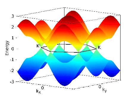

But now I'm trying to have graphene bandstructure in 3D like this:
But I can't do this.
Can you give me the MATLAB code for 3D-Bandstructure?
@sina67 ... here's a modified code for 3d plot:
%Plot of Energy dispersion trial1.m
x=linspace(-2.5,2.5,50);
y=linspace(-9,10,20);
[a,b]=meshgrid(x,y)
z= 3.033*sqrt(1+4*cos(b*0.1*pi).*cos(a*1.2283)+4*(cos(a*1.2283)).^2);
zz=- 3.033*sqrt(1+4*cos(b*0.1*pi).*cos(a*1.2283)+4*(cos(a*1.2283)).^2);
figure
surf(a,b,z)
title('Energy dispersion relation of graphene')
xlabel('K(1/A)'),ylabel(' Energy of graphene(ev)')
hold on
surf(a,b,zz)
