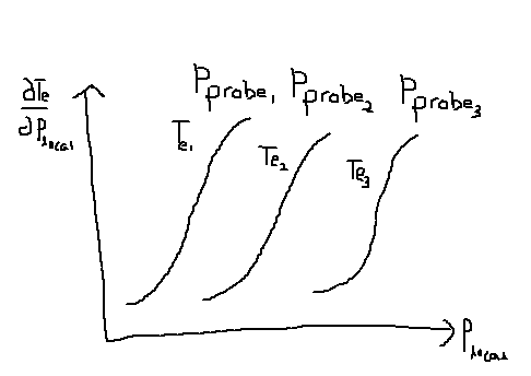

[tex] 1 - 2 P_{probe}|\Gamma| \frac{\partial |\Gamma| }{\partial P_{local}} = G_{eb} \frac{\partial T_e}{\partial P_{local}} [/tex]
I want to find the contours of ##\frac{\partial T_e}{\partial P_{local}}## against axes ##P_{local}## for various values of ##P_{probe}, T_e(1)## ranging from ##0## to ##10^{−14}## and ##0## to ##0.1##

I'm using mathematica. I've updated my code above and drastically simplified the problem. Now what's left to do is to implicitly diffrentiate and plot ##\frac{\partial T_e}{\partial P_{local}}## against ##P_{local}## for a given family of curves given with various values of ##P_{probe}##.
Differentiating ##\Gamma## to find ##\frac{\partial T_e}{\partial P_{local}}## manually is very tedious, so I want mathematica to do that for me to find ##\frac{\partial T_e}{\partial P_{local}}## and plot it.
How do I tell Mathematica to:
1. differentiate ##\Gamma## to find an expression for ##\frac{\partial T_e}{\partial P_{local}} ##
2. Insert in value of ##T_e## ranging from ##0## to ##0.2## and value of ##P_{probe}## ranging from ##0## to ##10^{-14}##
3.Plot contours of ##\frac{\partial T_e}{\partial P_{local}} ## against ##P_{local}## for various values of ##P_{probe}## and ##T_e## ?

I've discussed this problem with my supervisor, and I've realized I've gotten this all wrong! We know the following:
[tex] T_e (P_{local}, P_{probe}, w) [/tex]
[tex] \frac{\partial T_e}{\partial P_{local}} (P_{local}, P_{probe}, w) [/tex] I'm supposed to do the following:
1. Find the contours of ##T_e## at the limit ##P_{local} \rightarrow 0 ## i.e. contours of## T_e (0, P_{probe}, w)##
2. Find the contours of ##\frac{\partial T_e}{\partial P_{local}}## at the limit ##P_{local} \rightarrow 0 ## i.e. contours of ## \frac{\partial T_e}{\partial P_{local}}(0, P_{probe}, w)##
I'm really sorry about wasting your time with the earlier problem. I'm trying this new approach here:
1. Get mathematica to obtain expressions for ## T_e (0, P_{probe}, w)## and ## \frac{\partial T_e}{\partial P_{local}}(0, P_{probe}, w) ## by rearranging and solving.
2. Plot the expressions.

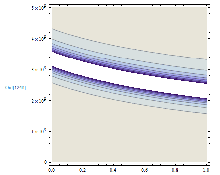

ContourPlot[y[Te, w], {Te, 0, 1}, {w, 0, 5*10^9}]
ContourPlot[
 Te /. Reduce[Pprobe (1 - y[Te, w]) == (Te - Tb) Geb, Te], {w, 0,
  5*10^9}, {Pprobe, 0, 10^-14}]
What's interesting is that I've managed to obtain a contour plot of ##|\Gamma (w,T_e)|^2 ##:

ContourPlot[y[Te, w], {Te, 0, 1}, {w, 0, 5*10^9},
  FrameLabel -> {"\!\(\*SubscriptBox[\(w\), \(probe\)]\)",
    "\!\(\*SubscriptBox[\(T\), \(e\)]\)"}];
ContourPlot[1 - y[Te, w], {Te, 0, 1}, {w, 0, 5*10^9}, Axes -> True,
